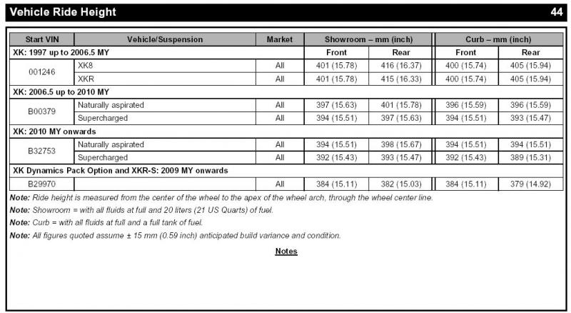

Check the ride height, measure from the center of the wheel UP to the bottom edge of the fender. It should be about 15-3/4". If it is less you'll have excess negative camber. (Mine is 1" too low still after new spring pads so I got new springs as the old ones are 15 years and 176k miles old. We'll see how much it helps after I get it back on the ground this weekend.)
Here's a chart I copied from another thread that shows the ride height for different models.
Mike

Originally Posted by oregonjag
slight excess wear on the inside of the front tread is normal.
Mike
uh not really, only when techs doing alignments dont pay attention to suspension deflection, and or dont set toe to the inner most toe'd in spec or further if more deflection when checked by doing a mercedes benz "pressor bar" check of the front suspension. I get even wear in front from my customers as long as they dont knock the alignment out.
