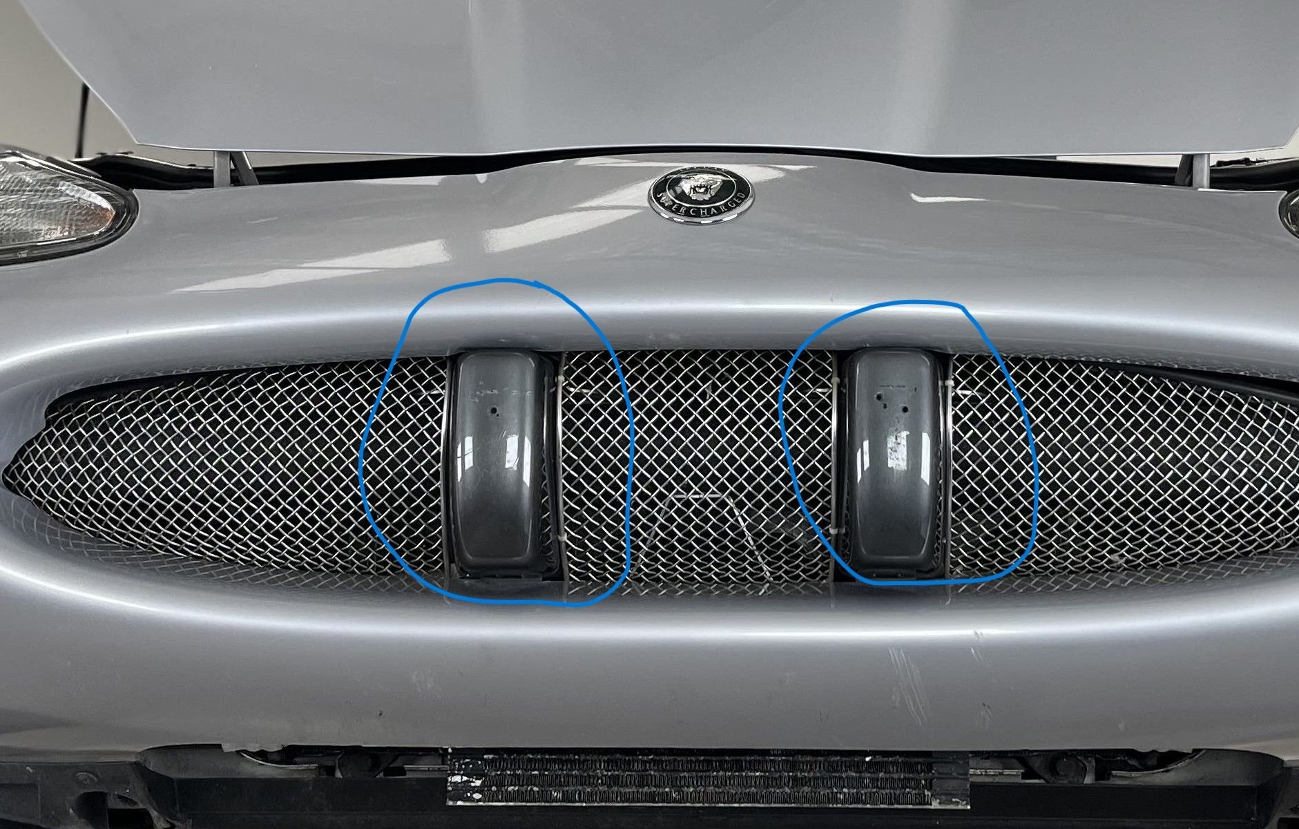

Its not really hard, but it is not trivial for sure. This pic shows what you are up against.
Before

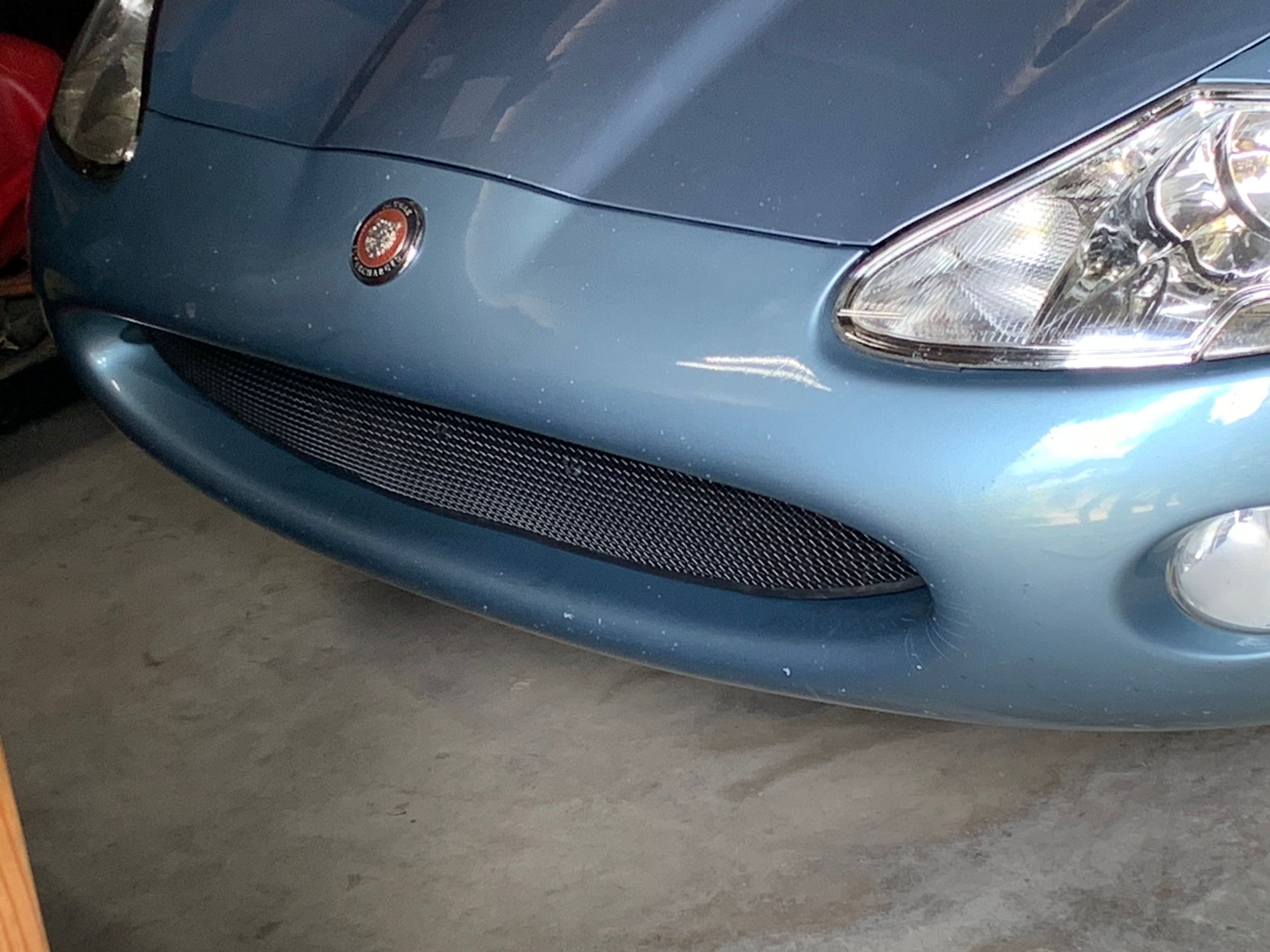

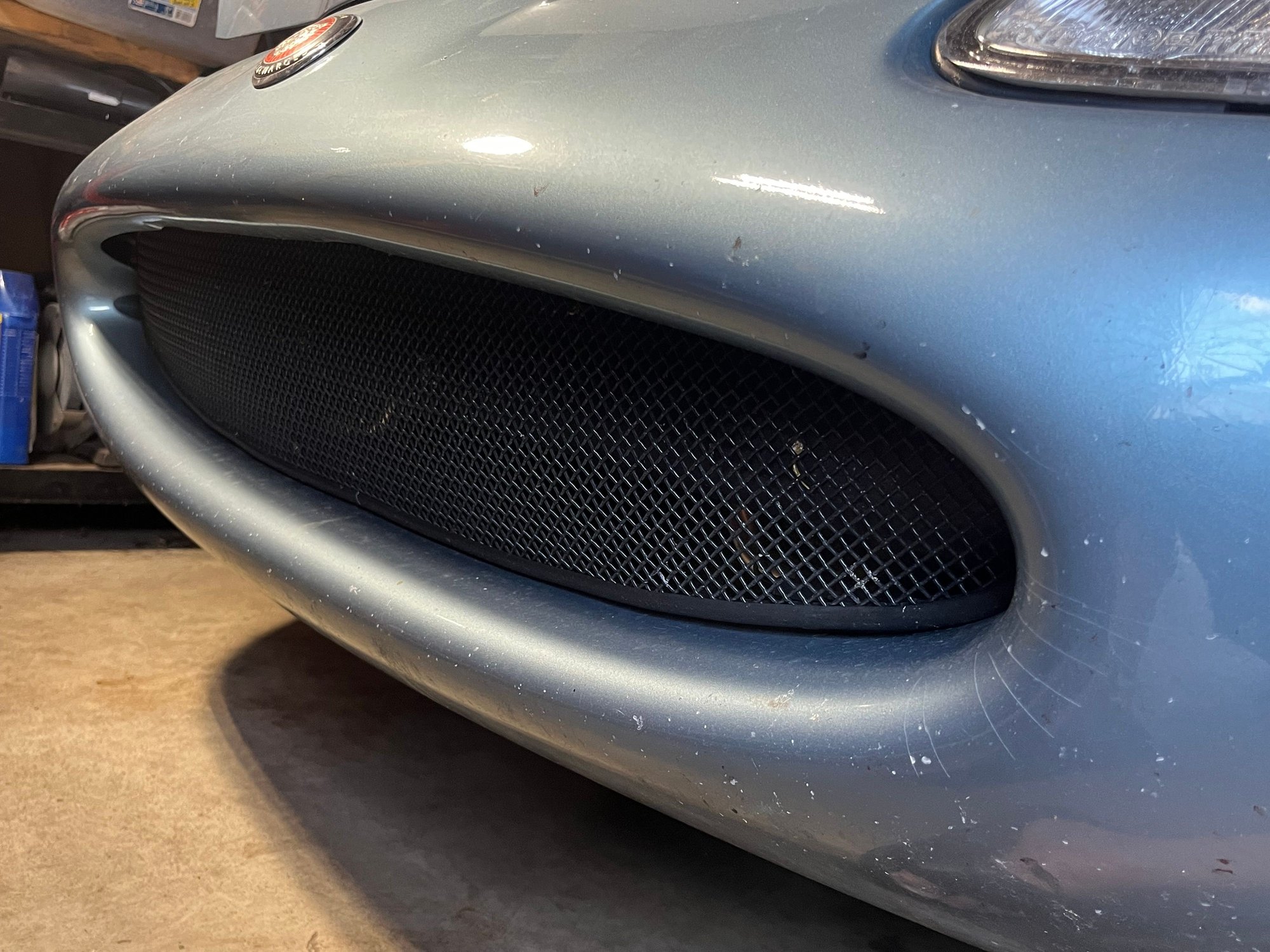

After - grill from Adamesh
