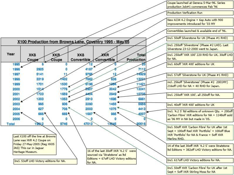

It is possible that you have an 'XKR 100'. It should have markings.
If it is a Convertible, then only 250 were made LHD for the NA market.
If it is a Coupe, then it is really rare, as only 30 were LHD and went to NA. The other 220 remained in the UK. See Production numbers below.
