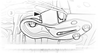

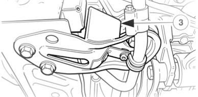

Originally Posted by rumm5
I have no idea what the horns on the front are for. Also,I saw the steel mounting brockets on the front of the subframe have an additional mounting fixture the older one doesn't.
The extra 'horns' on your subframe were introduced in 2001MY to improve occupant safety during front-end crash. In a front end collision, the subframe 'horns' interface with the bracket extensions to improve crumple zone performance. Your new brackets (MJE2541AC and MJE2540AC) had additional box section reinforcements (arrowed) designed to collapse and absorb energy. These were all part of mid-cycle updates introduced to achieve the highest rating of the European crash test.
So, in summary, you have upgraded your car for superior crash performance. Well done and hope you never need it !!
