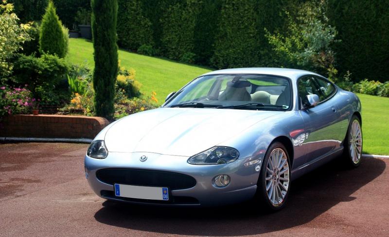

The photo below shows what 15mm spacers look like on the rear of my car. You can barely notice they're on (which is what I want), but when I remove them, it makes the car look 10 years older.
Now, if you look at the front wheels, the case for spacers is less obvious. I think it would look odd if the tyres protruded even a little bit from the wheel arches. Unless they make some 8mm spacers one day...
