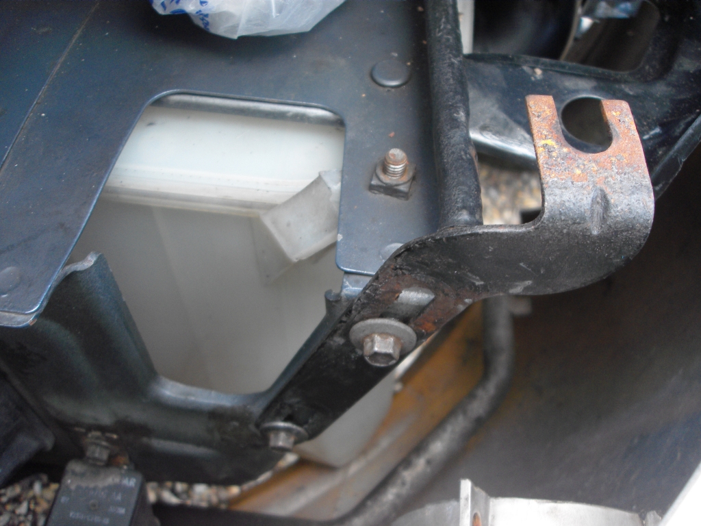

Haven't removed the wing, but I have removed the complete "plastic" bumper assembly. There are three bolts on each side which hold the bumper to the wing. The "nut end" is captive / welded to the wing. Mine were quite rusty and one broke away which made it even more awkward to remove. Might be worth a good dose of penetrating fluid the night before you get the spanners out.
Also - headlight removal is a complete pain. Top torx bolt is OK. You only need to loosen the one at the side - the lamp assembly slides in. But .......... there's one underneath which is a brass bush in the plastic and will probably have rusted solid.
I eventually got mine apart, and then stuck it back in with araldite and a small cable tie to keep it firm until set.
Front wing/fender removal-16072015-003.jpg
Others might know better, but I wonder if it's worth the exta hour or so to remove the complete bumper - makes access to the wing a lot easier I would imagine.

johns55 - yes - you're right. But - with the complete bumper removed, it's much easier to get the headlight out particularly if that stupidly designed steel bolt into brass bush has seized solid.
If necessary, you can then remove the bracket that the headlight is attached to underneath along with the headlight.
Front wing/fender removal-16072015-008.jpg
I guess it's swings and roundabouts, but worth considering maybe ??
