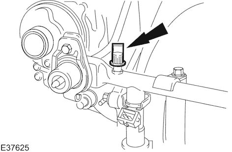

On my 2000 XK8 it is on the fuel rail, passengers side close to the firewall. Really easy fix, generally.

The Regulator is to the rear of the (pointed to) Schrader Valve:

Thanks for the help. As it turns out, my FPR is located on the US passenger side, at the end of the rail closest to the firewall. The schrader valve is on the opposite end, on the opposite side of the car. I'm guessing they changed things tremendously from year to year?
