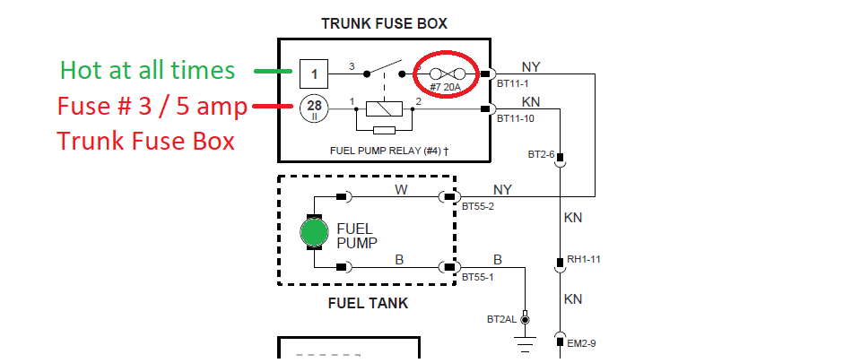

1. do not hear fuel pump running, 2. no fuel at Shrader valve, 3. it kicked a little when I sprayed starting fluid in air cleaner hose. Since I see voltage at the fuel pump connector, I think it points to dead fuel pump. They don't seem expensive, but there are 6 or 7 choices. ie. Denso, Delphie, Airtex, etc. Not sure which is best choice.

Recommend swapping the pump relay as it may have pitted ( inside ) power contacts not allowing enough current to run the pump .
Put your finger on the relay and feel for it to click , there is a fuse for the relay control and a fuse for the power passing through to the pump
Also the fuel filter as a otherwise scheduled item
Bore wash condition is also a possibility as you go through this anomaly .

Thanks, I had previously tried swapping relays. I did put voltage meter on the connector wires leading to fuel pump, and I'm getting voltage to the pump when initially turning key, so I assume circuit is good to the pump.

There is a fuse between the relay and the pump connector and not the usual way before
Electricity in the tank is common dependent on the design , think TWA Fight 800 . I worked on the left wing wiring just before it got shot down .
The pump will charge the fuel rail for 3 - 5 seconds and turn back off . It will turn back on after the ECU sees engine rotation by the Crankshaft sensor .

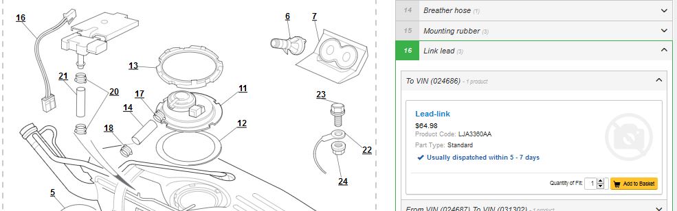

I got the fuel pump out and it checks bad. Took me about 5 hours with car on jack stands, mostly siphoning out gas and getting fuel lines apart. Job was about as expected based on the misery others described on this forum.
Now the problem is the link lead (wire jumper with white plastic box) has burned connecter where it connects to pump. I dont see this part readily available and what are my options? Im not too excited about splicing wires that are in fuel tank... can i eliminate this, but not sure if new pump has connector that will work without the link lead. Thanks

I believe the box is a electrical noise suppressor found on later years or a TSB

You can find a blow up of the fuel tank and components at this link: https://www.sngbarratt.com/us/#!/Eng...RUNNING%20LOSS
Attached is the screen clip from the page.
You can download the complete catalog in PDF from their web site

Replaced fuel pump, link lead, and fuel filter. Very satisfying to be back on road, running like new, and saved probably around a grand in labor! Greatly appreciate all information, or I wouldnt have known where to begin or what to expect. Did this on jack stands, so fuel-line disconnect was extremely tricky part.The helpful tip to tie string to disconnect tool helped alot, and I used long screwdriver, stick, and jammed my hand in small space to remove/replace the lines.
The pump was reasonable at $70.00 with lifetime warranty. On the other hand, the lead link was also $70.00, and was just 2 wires and connectors, and it didnt even have the noise suppressor.
