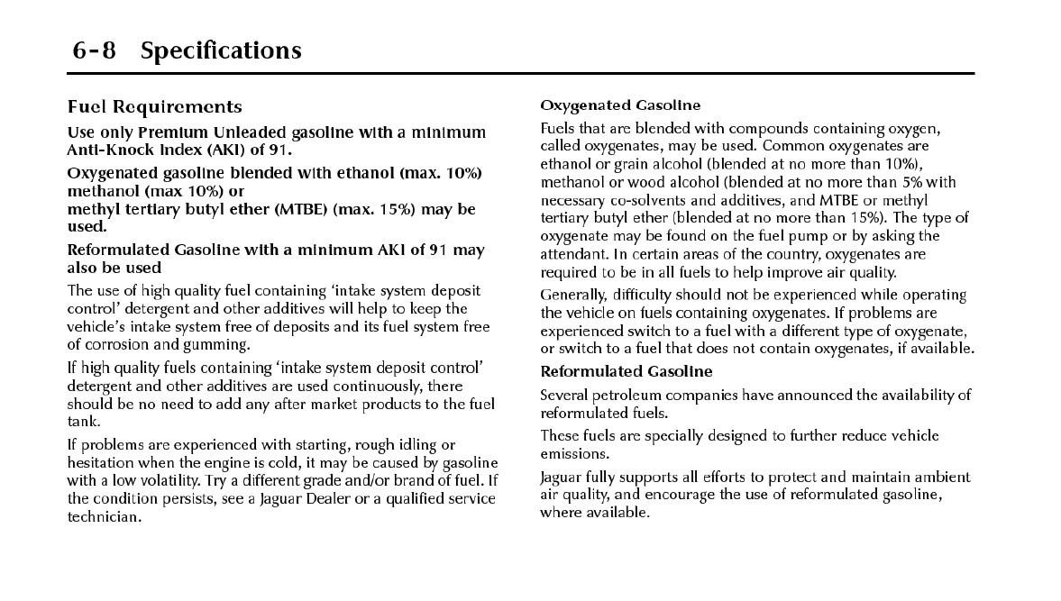

I have heard (and been told) that the best gas to use for my 2000 XK8 is BP premium. It has also been suggested to use premium un-oxygenated. Any comments or recommendations and explanations as to why? Look forward to your responses. Thanks!

Frank,
Here's the Jaguar recommendation from the US 2000MY Vehicle Care Handbook:
The full sets of handbooks are available to download as PDF's from this link in the HOW TO thread:
https://www.jaguarforums.com/forum/x...-2003-a-67827/
