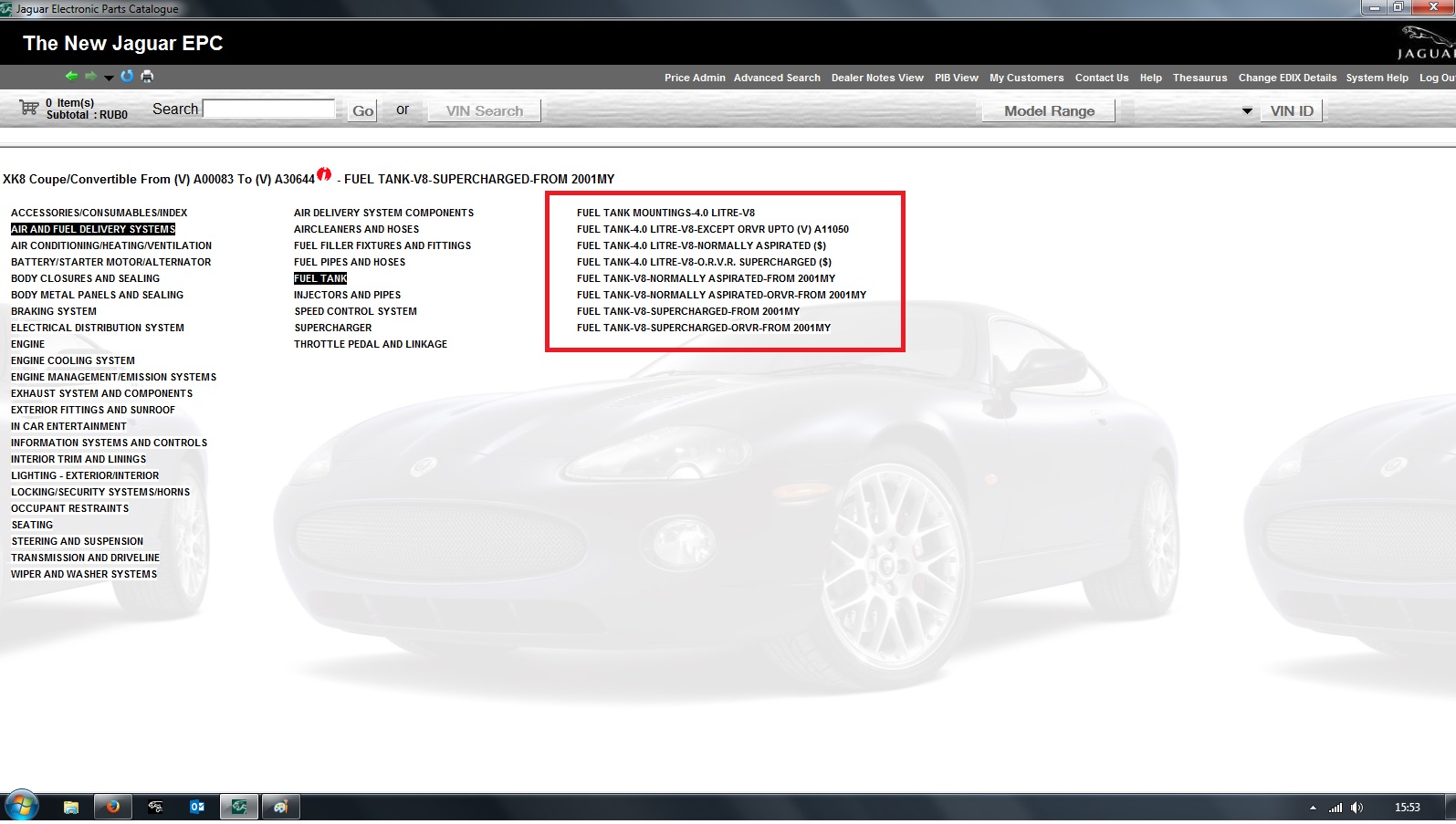

Old Jul 14, 2014 | 09:58 AM
Tony,
Does your VIN come in these ranges (see item 2):
It gets complicated in 2001MY with several options to through (see section I've boxed in red):
If you can identify the right one from these options, I can pull up the correct page and P/N from the Parts Catalogue.

they usually ask for the last 6 digets of the vin. here they are A14208
part is the fuel sender..... thanks again tony

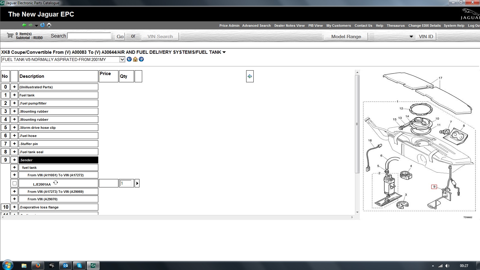

Old Jul 14, 2014 | 06:40 PM
Tony,
I'd just been reading a thread on fuel pumps and missed the all important word 'sender' in your post.
Here's the Parts Catalogue extract (see item 9):
For the 2001MY and your VIN range, it's the same P/N LJE2001AA for both Normally Aspirated and Supercharged with or without ORVR.

Cool fuel sender
Originally Posted by GGG
Tony,
Attachment 90684
thanks again will order it as soon as i get the nerve to tear either my tank out or drill a hole down into it and try to go through the top lol tony (only a weekend mechanic)
