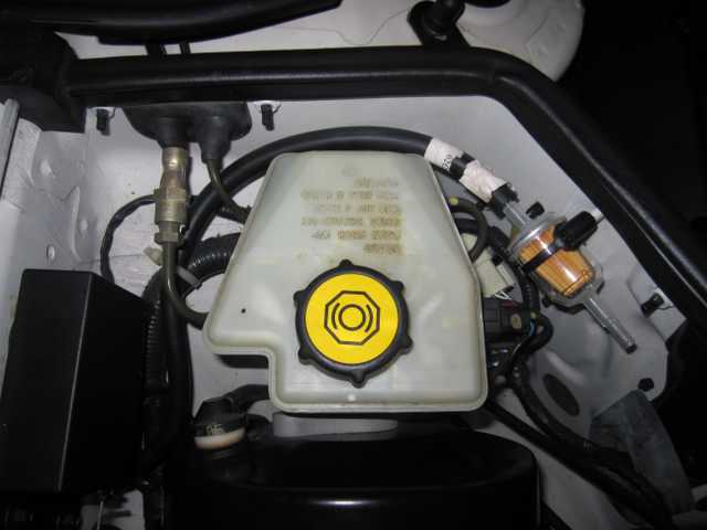

Default Fitting a new purge valve
Hi Blakeb1 I had a similar gas smell in my 2001 XK8, I had the smell just inside the offside wheel well at the top. I replace the fuel cap with a new one, that did not work. # weeks ago I replaced the purge valve in driver side wheel well see tsb provided by WhiteXKR in this thread, so far no smell and in fact my tick over has increased by around 50-100 revs, not sure why, but car is running great.
I managed to replace the purge valve by turning the steering wheel all the way to the left and had enough room to remove the wheel inside cover to get at the purge valve. Also, the new valve I fitted (see part number on the TSB) had an opening on the top which you connect a rubber tube plus filter. You need to instal the rubber tube to the top of the purge valve while its disconnected as its a very small hole in the tube and you have to push real hard to get it on. At least I did but then I am getting real old.
Will try to post some pictures I took which may help. Total cost for all the parts around $100 well worth it.
