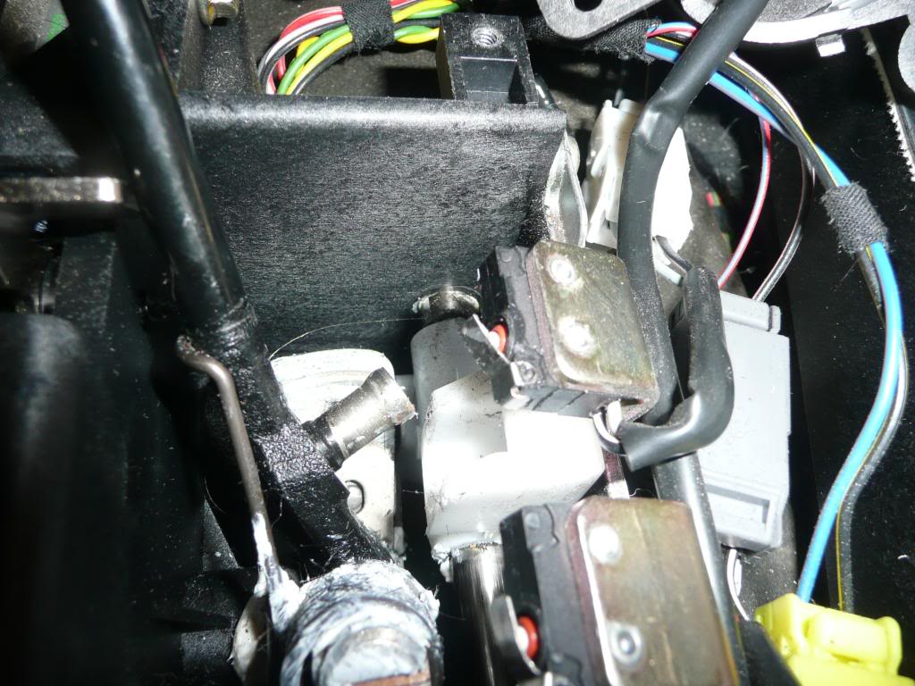

Get a pic up Matt, and perhaps check w/ ken@britishparts at his store. He may have access to diagrams that we do not, or perhaps describing the parts, he could help you.

Those are two basic lever micro switches that are riveted on to a bracket. Jaguar probably sells the replacement part as the switches and bracket as one part, i.e. expensive. If you have the skills, you can probably drill out the rivets and replace the individual switch with a generic lever switch available from most any electronic supply company. Bolt it on to the bracket and splice into the wiring. You will need to know if the switch operates as a normally closed or a normally open switch.
