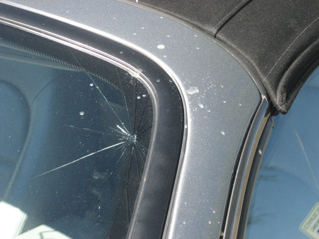

Unfortunately my car was pelted with hail while at the shop; the owner and his team did everything they could to save as many cars as possible, but that is what insurance is for, right? Pics are below, its hard to tell unless you look closely, but it looks like a new bonnet, deck lid and windshield are in order. And then there is the indignity of the corvette parking sign. (I guess if it was "plastic fantastic" I'd only need a windshield)
Official claims adjustment is due on Monday. - Mr.Texas Dan how is your hail experienced ride? I never saw any updates.

I tell you what, before going full out body panel replacement, let a paintless dent removal outfit try their magic on the non-creased dents and dings. I've had 5 big dings (by inconsiderate owner's doors) heavy handed mechanics leaning on the fender, and one forgotten screwdriver left atop the ABS module (bulging UP into the bonnet) all were fixed w/o any signs it was previously damaged.
I only say this because older paint is SOOOO difficult to match, and if you're an extremely critical person like me, I'd notice. And, new body parts and repaint are criteria that will hurt resale on the car, especially if you try to trade it into a dealer, they throw that 'paint gauge' data and unmatching finish (you know, orange peel vs smooth?) at you. Everyone has told me not to repaint my bumper or hood just to fix a couple chips, as it'll lower my car's value more than leaving them.
Thanks but the paintless dent removal guys said there are too many dimples on those panels to fix correctly (you can't really tell from the pics unless you look really closely, the resolution was reduced for posting). And yes I am extremely picky, even with 96K miles the paint was like new except for a few stone chips and front end scrapes on the lower part of the bumper. Essentially the car will be going to a restorer quality body shop, the shop owner felt bad that he could not rescue the car so he is calling in some favors. Hopefully I'll have it back before Christmas!
