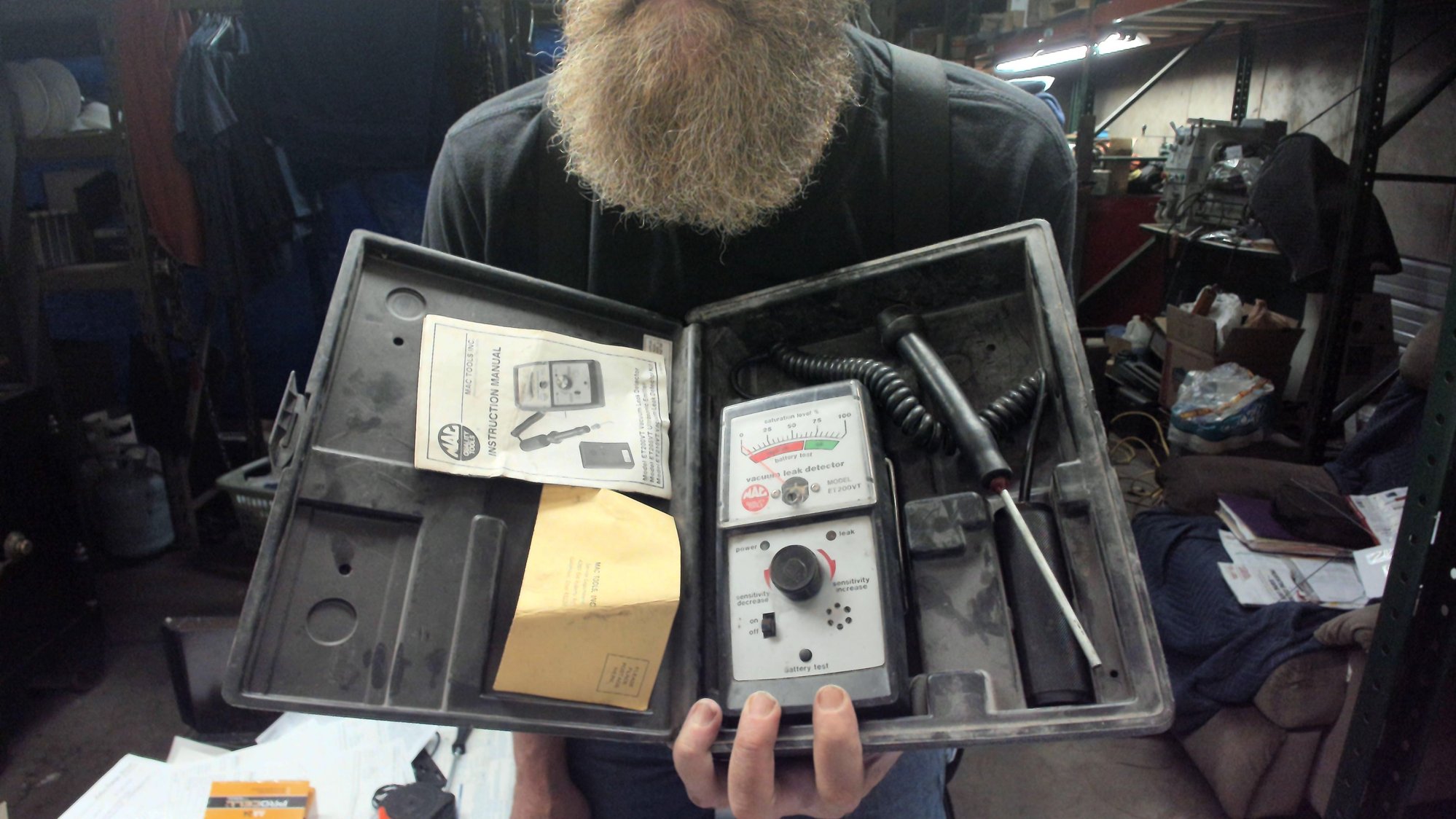

My hearing is still darn good for my age but the days of hearing a TV flyback transformer working from 3 rooms away are behind me now. I do have a MAC Tools Vacuum Leak Detector model # ET200VT that is extremely sensitive, almost to sensitive though as some electrical noises will cause false positives.

One of these would be handy lol
