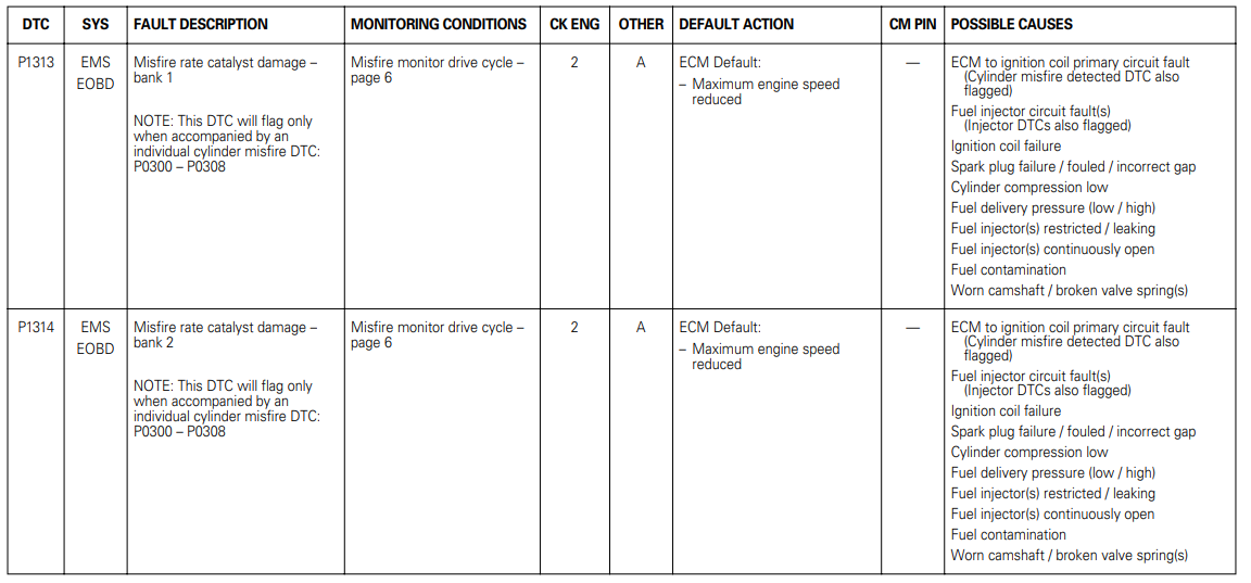

Originally Posted by avos
Just for info, I am not familiar with the B1313/14 codes, but P1313/14 is known:
Im thinking the b1313 codes are some kind of miscommunication between the reader and the car.
From what I can tell, there isn't anything on the car that relates to it.
Going back to how some scanners may mis read or not read, depending on where he got that information from it is possible that your scanner mis interpreted the "P" as a "B". Looking at the information he posted about the P1313 and P1314 does make it plausible. Although you are not setting any P300 to P308 codes which should be appearing if the information is correct. I think it would be a good idea to see if some one local has a different scan and data device. Also never underestimate the ELM237 scan devices. Even tho I have numerous high end scan tools, I do use the ELM 237 on occasion. Some where on this site i remember seeing where one of the regulars has done some testing on where to get the better more reliable ELM237 device and an app that works better than most
