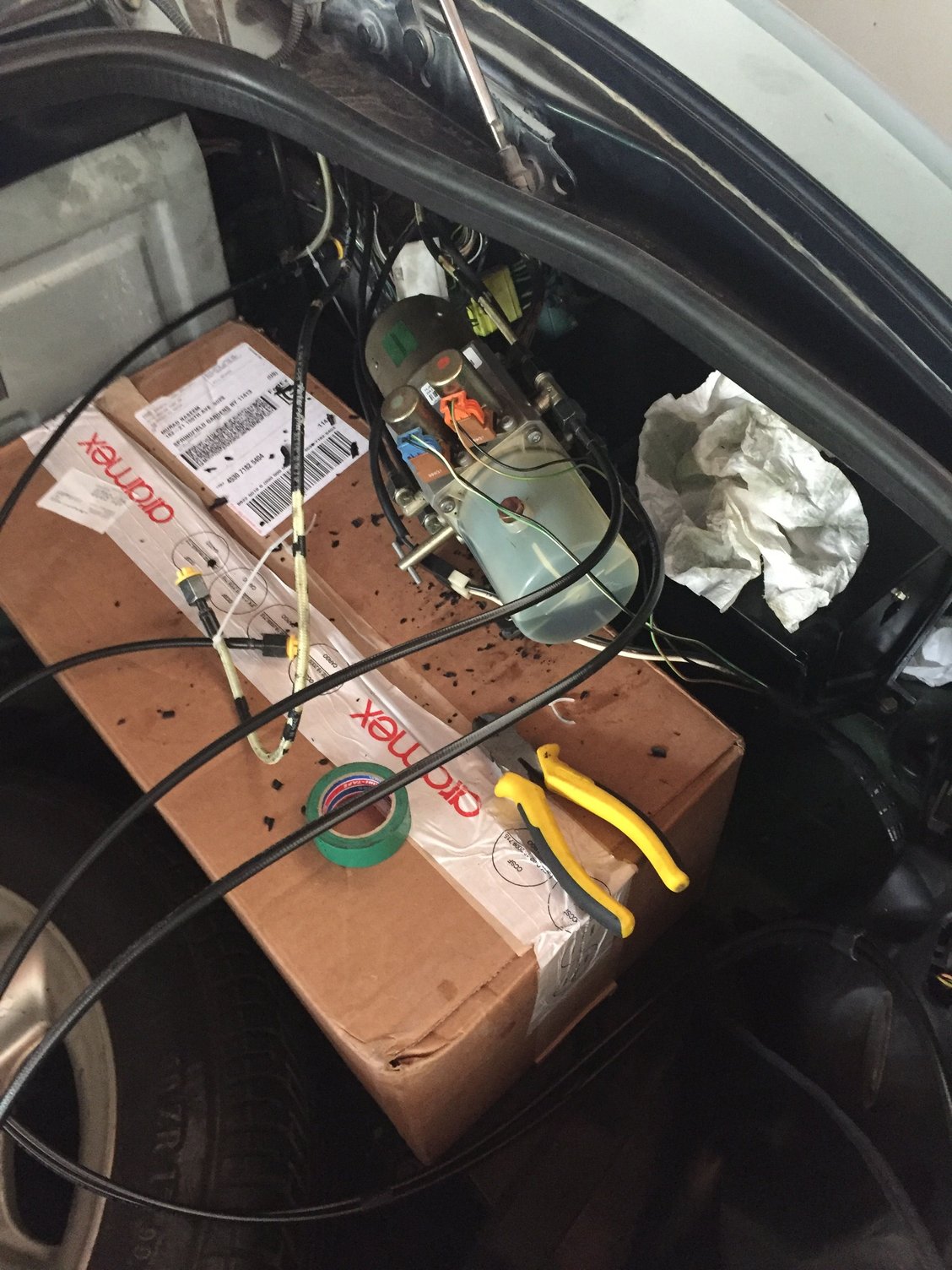

Default 6 lines to the latch. Check out the pic
In the RHS of the trunk/boot there’s 6 lines from the pump - for 2 hydraulic rams (LHS and RHS in pairs) plus 2 to the latch. In my picture below, the latch lines are on the LHS.
In the pic, note the flakey black plastic sheath coming off the old hydraulic pipes.
Looks a lot more scarey then it is. Hydraulics are generally very simple systems. Just very messy when they go wrong
That makes more sense now. 6 lines not 2.
