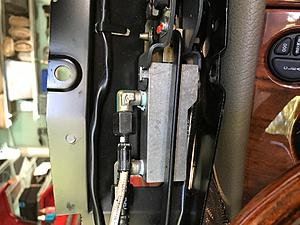

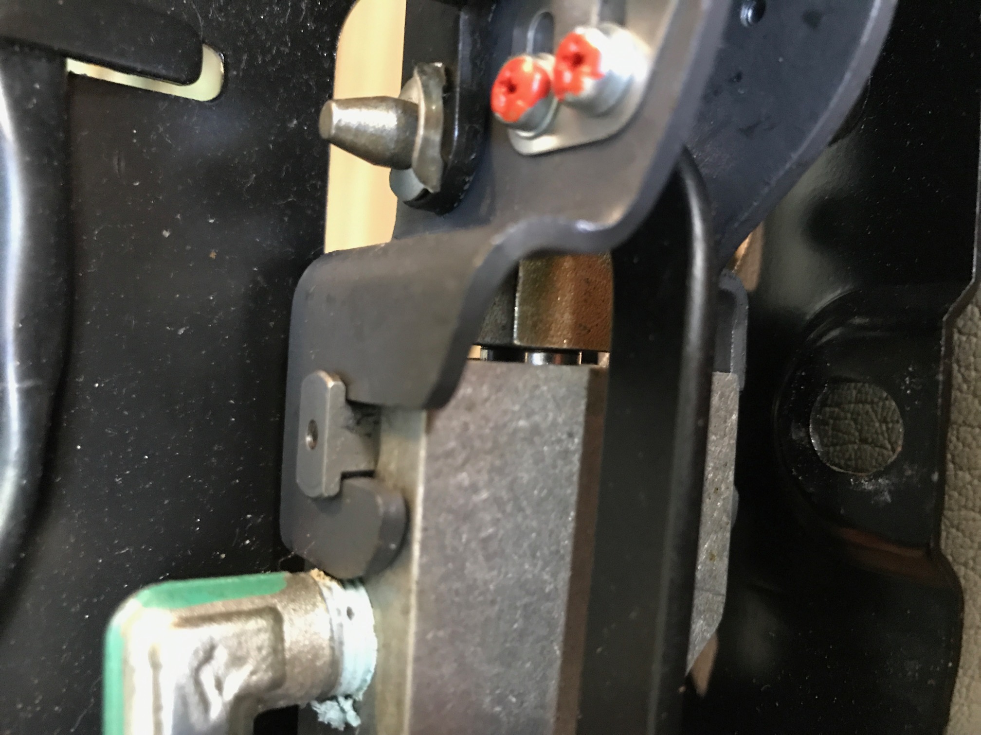

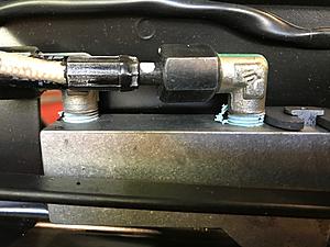

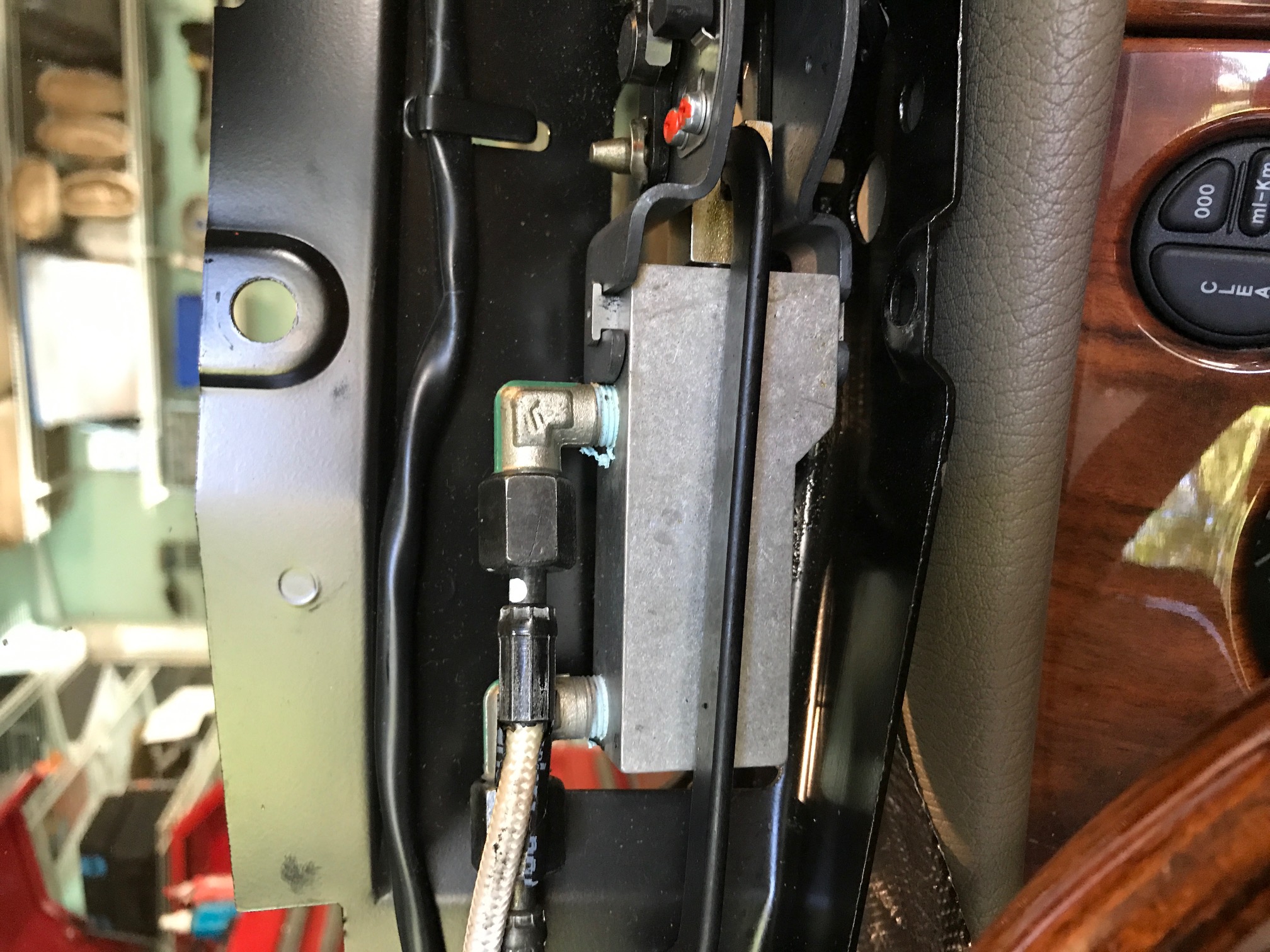

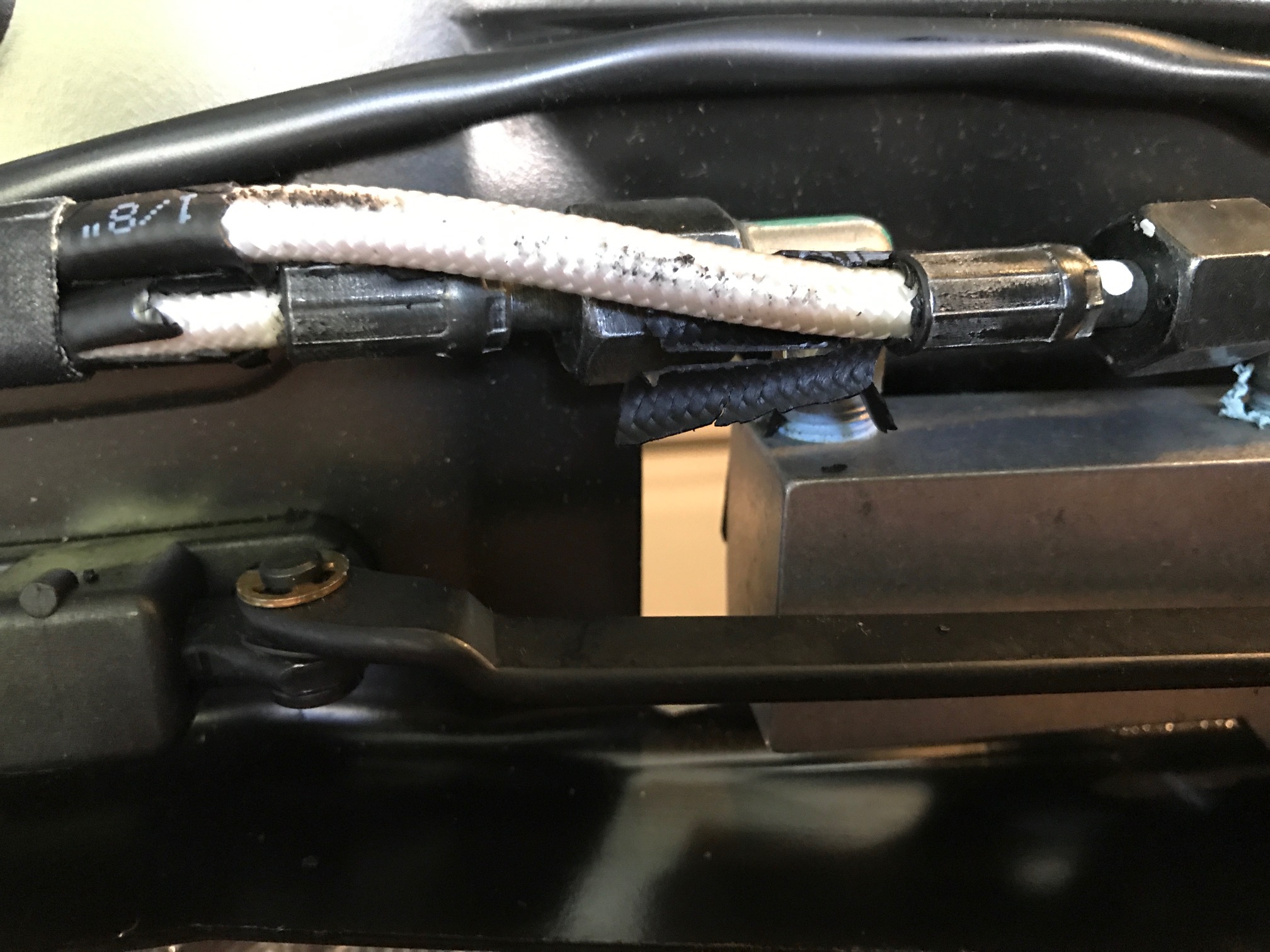

In an over abundance of caution, I took apart my latch system when I noticed the first drop of hydraulic fluid. As you can see, the leak seems to be very minimal, however, the issue seems to be that I do not know where it is originating from. My guess is the hydraulic ram as the connections look dry - any advice?

If it were me - just looking at the hoses - it is only a matter of time before they separate from the connector and you have a true green shower. Recommend replacing hoses and having top hydraulics rebuild the latch ram.
I would check the hoses and lift rams as well. A complete set of hoses from either Top Hydraulics or Cabriolet Hydraulics run around $600. Top Hydraulics will rebuild rams not sure about Cabriolet Hydraulics.
