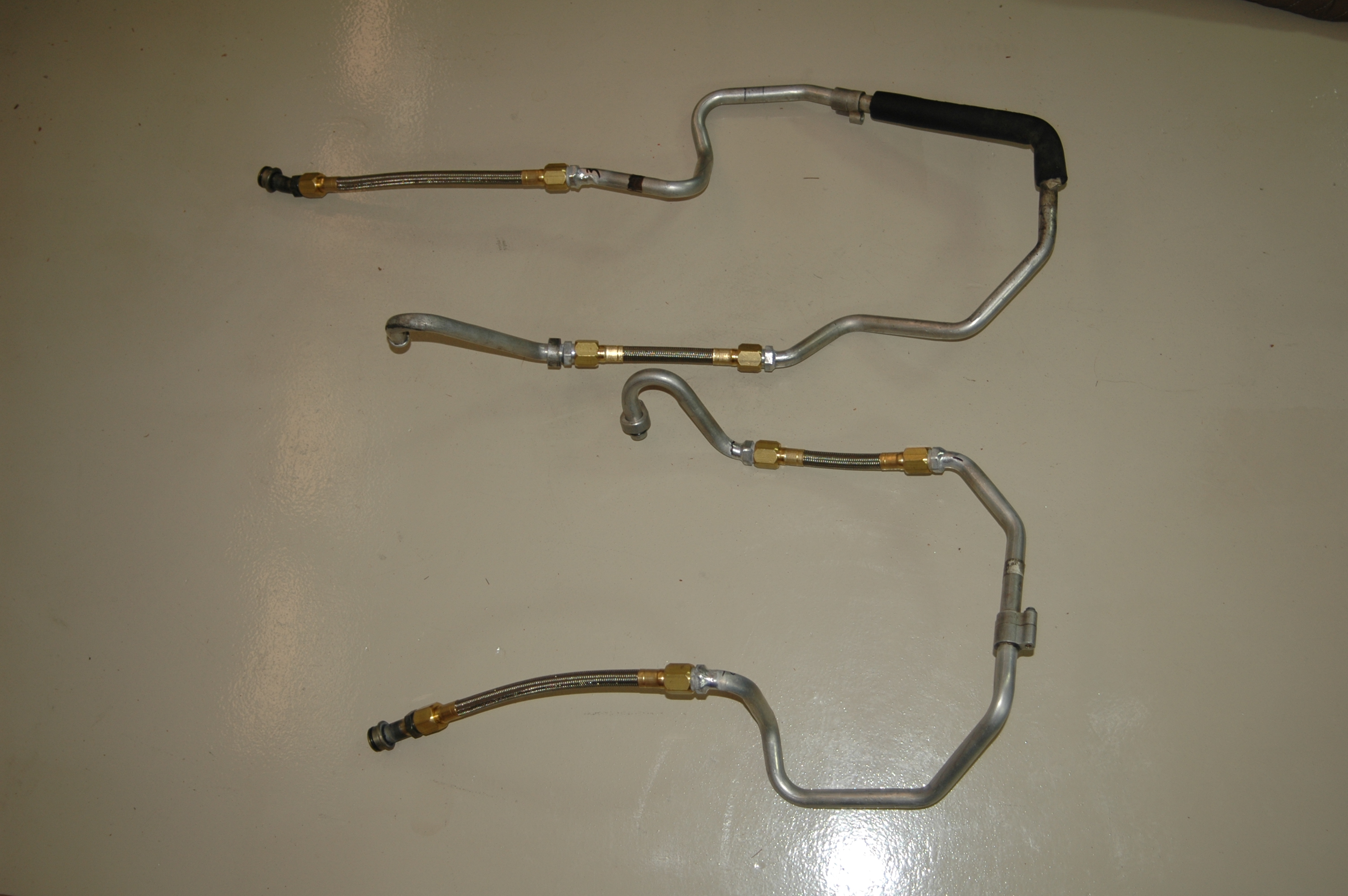

Here in the Arizona desert rubber does not hold up as well as it does in other climates. Most of you will agree that the OEM rubber lines to the oil cooler are a disappointment and a disaster in waiting.
One solution is to upgrade the rubber portion of the lines with superior materials such as multi layer braided stainless.
Arizona Tubes and Hoses in Phoenix did a great job with my lines, see photos for example. aztubesandhoses.com 602-253-4507. Hal is the owner is memory serves me well. Cost was less than replacement of the OEM grenades.
Attached Thumbnails Had a massive loss of oil while driving this week-dsc_0007.jpg   Had a massive loss of oil while driving this week-dsc_0001.jpg
