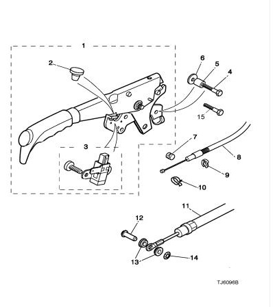

Old Mar 28, 2015 | 04:49 AM
Originally Posted by RayG
The "Hand Brake On" warning no longer comes on, on my 2005 XK8. .............
Ray,
My prime suspect would also be the Handbrake Switch (see item 3) or its harness connections:
This diagram is from JEPC (Jaguar Electronic Parts Catalogue). The Parts Catalogue diagrams are often more helpful than the ones in the Workshop Manual!

This may help :
The wire goes into the side of the microswitch, not the base, and it can pull out fairly easily. This is what I would check first.
