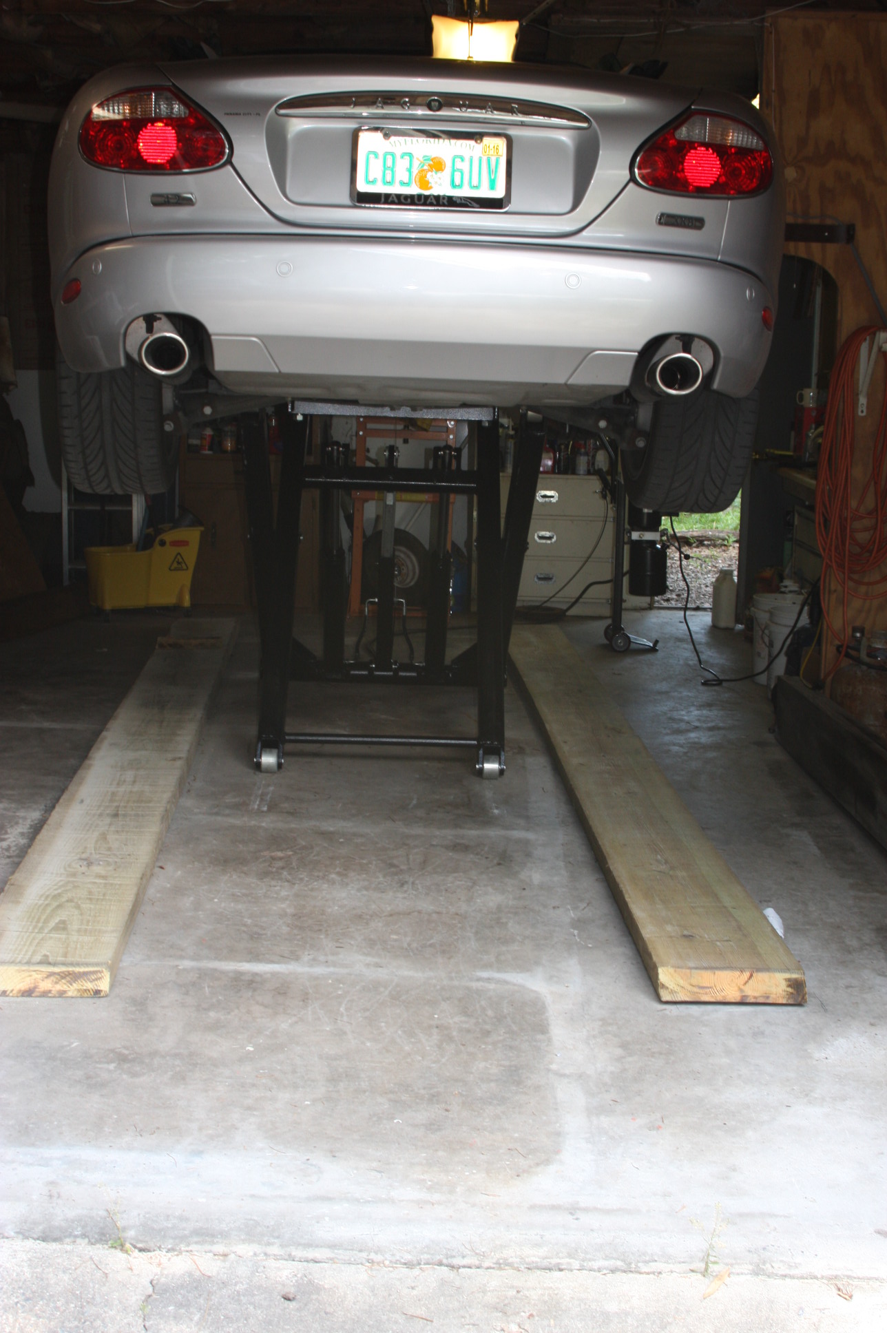

ATLAS SCISSOR LIFT PHOTOS:
Attached find photos of the ATLAS scissor life I installed in my small country garage.
#1: Lift and Power Unit
#2: Rear View
#3: Where Garage Door power Unit is when Car at highest point (Top Down)
#4: Trying to show how high Lift Raises Car. About 4 inches shy of a new Broom.
#5: Forward Lifting Arm (Left side)
#6: Rear Arm
#7: Looking Aft
#8: Lift Rams and Locking System.
#2: Rear View
#6: Rear Arm
#7: Looking Aft
