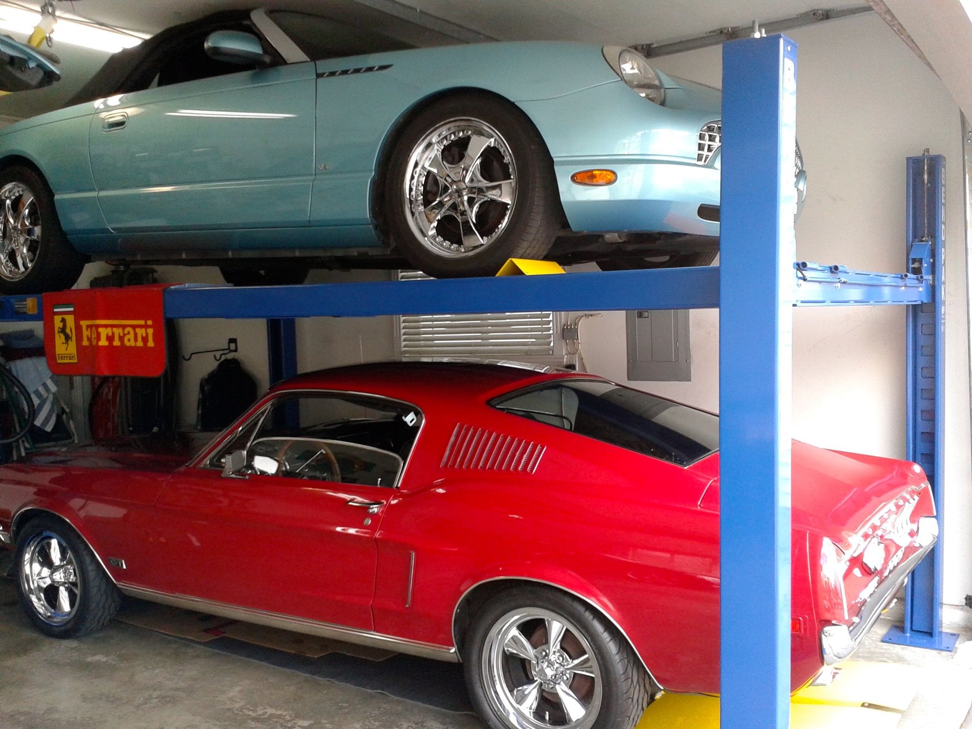

Here's my Danmar MaxJax bought from Garage Equipment about 1 1/2 years ago. It works great. I took out the XK8 tranny on it.
