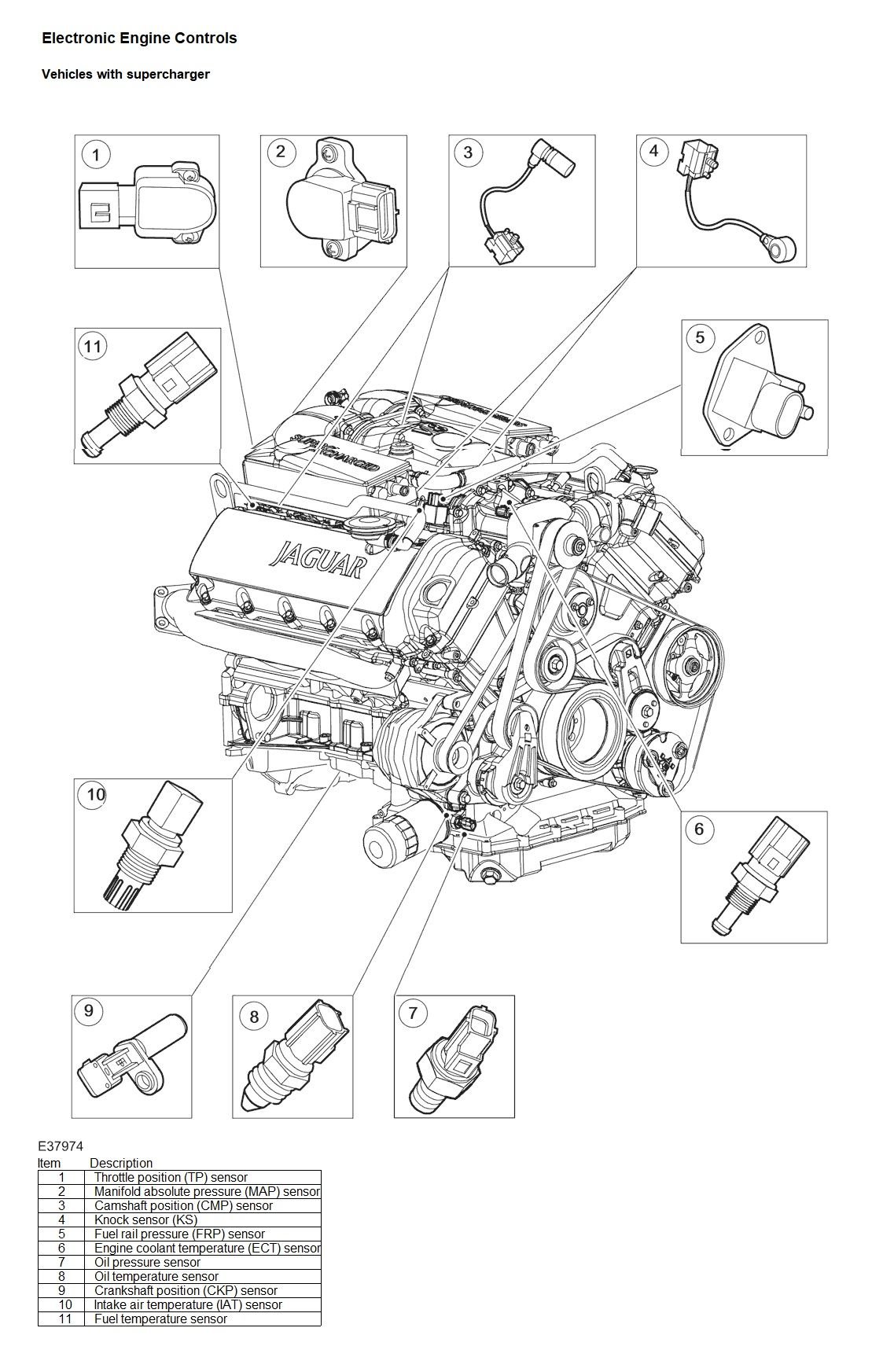

As this only happens in COLD weather and the engine runs normally when up to temperature, a faulty temperature sensor is also a possibility.
Of the four temperature monitors, the ECT is the one with a flakey reputation.

I had this problem once... It forced me to go ahead and clean up as many of the major sensor wires I could. Especially MAF sensor. Then, the two (on my 2002) cam position sensor connectors (I don't think it was that), knock sensor connectors, and a few around the throttle body... Removed the breather to get to things and the engine covers. And the sensor at the the underside of the bell housing. Flywheel position sensor,,, or something like that. Problem went away. I think it was the MAF myself - but couldn't be 100%.
This might prove how little know, but it will be good to know... Is there a temp sensor that talks to the ECU? On my XJS and 928, the temp sensor can play a big part in causing misery... XJS will not start unless a proper (resistance?) signal isn't being sent...
