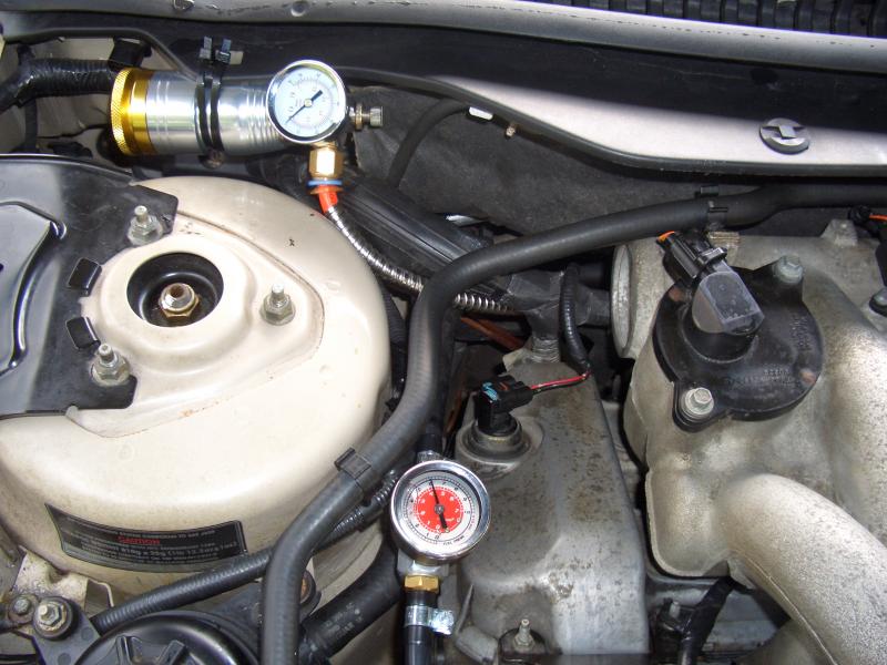

1st thing battery: the running battery watt is 14v not running is 12.7v thats ok
fuel pressure: 4.5bar as the jaguar techs state should be for this model
