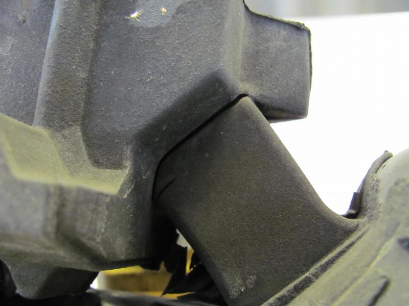

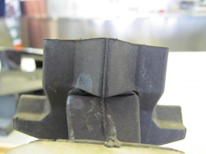

Originally Posted by H20boy
hmmm, any chance you kept one of the old mounts to show us the 'cracks' you speak of?
Here ya go...not pretty. This is all it takes to wreak havoc...
Attached Thumbnails Harmonic Drivetrain Buzz GONE!!! FIXED...-tiles-010.jpg   Harmonic Drivetrain Buzz GONE!!! FIXED...-tiles-011.jpg   Harmonic Drivetrain Buzz GONE!!! FIXED...-tiles-012.jpg

Thanks Skid and congratulations. I appreciate the photos. I'll recheck my own mounts but don't expect much as they've been replaced a month ago with my similar problem still occurring.
Jamjax: If my mounts show good (as they should), I'll likely take my driveshaft to a shop to have the balance checked. Thanks.

I remember when you said you had replaced all the mounts at Gaudin, so when we decided to replace the tranny mount I had absolutly no expectation that it would have any effect on the buzz, we just did it because it needed to be done. Seems like the most unusual things happen when expectations are nil.
