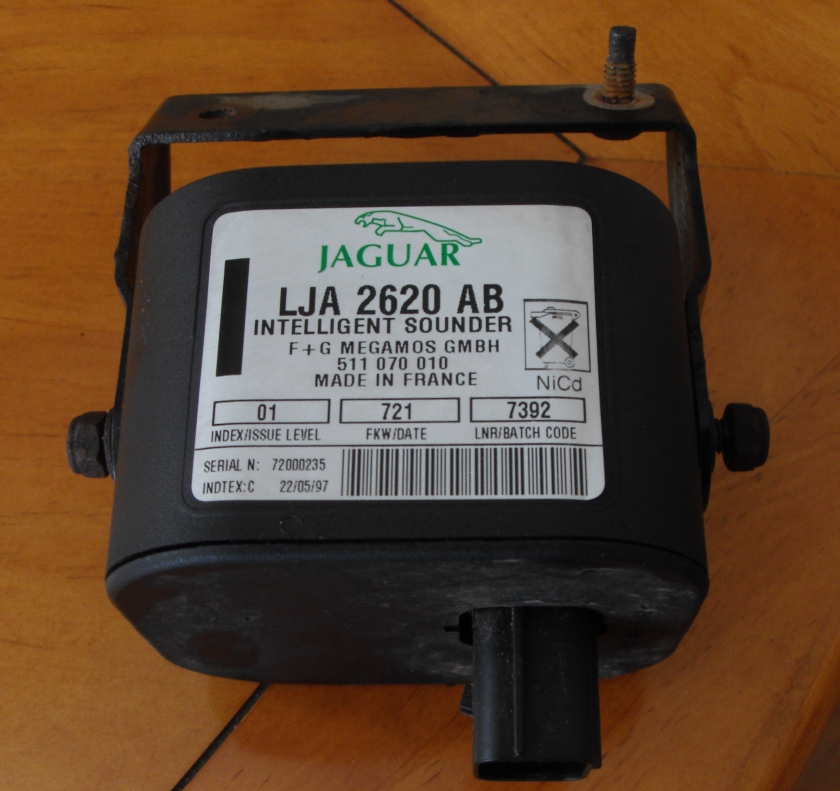

First thing to check is the type of sounder you have. Most (all ??) UK and European cars have an "intelligent" sounder which contains rechargeable NiCad batteries which at over 20 years old, are probably totally corroded and useless. Most (??) North American cars have a "passive" sounder which looks the same, uses the same wiring loom and connector, but which doesn't have an internal power supply.
With the steering on full lock, and armed with a torch, you may be able to take off the access panel in the wheel arch on the right-hand side and see what you have got.
If "passive", you could try a straight exchange with a "known-good" one - I got one shipped over to the UK from the US and paid around $20 US for it.
If "intelligent", you can still do a straight exchange, but you then have to re-programme the security system using IDS to recognise the change.
