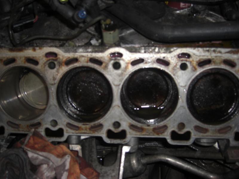

got back on the jag tonight took off the crank pully and timing cover another 200 bolts later and got the left hand head off see photos this gasket has failed in 3 places dosent look like OEM gasket either, no 1 piston on this side has had a steam clean,, although there is a lot of stuff to take off its not a bad job to do the only awkward bits were getting the crank pulley off, with the puller you have to pull it off a bit then tap it back on to release the tapered split washer thingy. a couple of the exhaust nuts were a pain but overall not too bad will continue and take off the other head maybe tomorrow night. One bit of good news is the supercharger I stripped it down there was hardly any oil in the gear end and the plastic coupler has worn out on the pegs. the rest of the charger looks perfect.

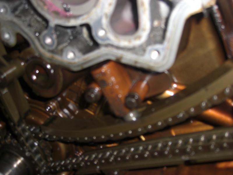

more photos as you could see in the last pics it has the old type tensioners fitted , they are still in good condition though , any advice on the best gasket set to order may go for original jag parts as I plan to keep the car

Thanks for the pictures. I'm curious as to why the front piston is so clean and the others normal. Could it be the result of the coolant leak in that cylinder? I had a simular experience with a 240Z.

water in bore will steam clean the top of the piston like in the pic had quite a lot going into that bore through the failed gasket
