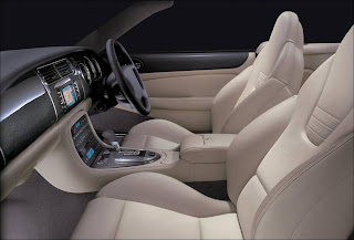

is the headrest supposed to be that 'curved' frog? You do have a separate headrest from the seatback, correct?
I have the Recaro Sports seats that were fitted as standard to the 4.2S run-out models in 2005. They have integral headrests which, while looking cool, are not as comfortable as separate adjustable ones. They're too far from my head and I never use them.
As for the steering wheel; yes, I live in France, but I bought the XKR in the UK (only 2 hours drive away from where I live), because prices are about 40% of what they are over here. Plus, there's loads more choice of Jaguars for obvious reasons.
