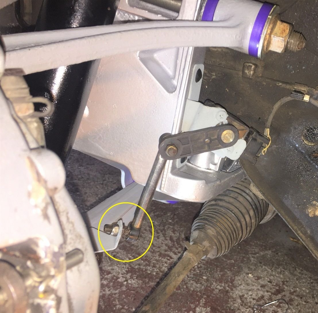

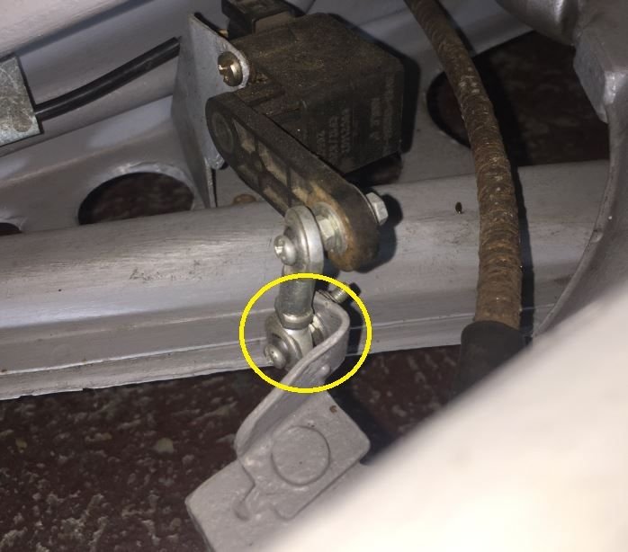

I suppose the easiest way is to disconnect the lower links of both front and back Sensor arms from the wishbones. Then move Sensor levers to a different position before engine start and see if the beam level changes. Probably easier with both left hand wheels off.
