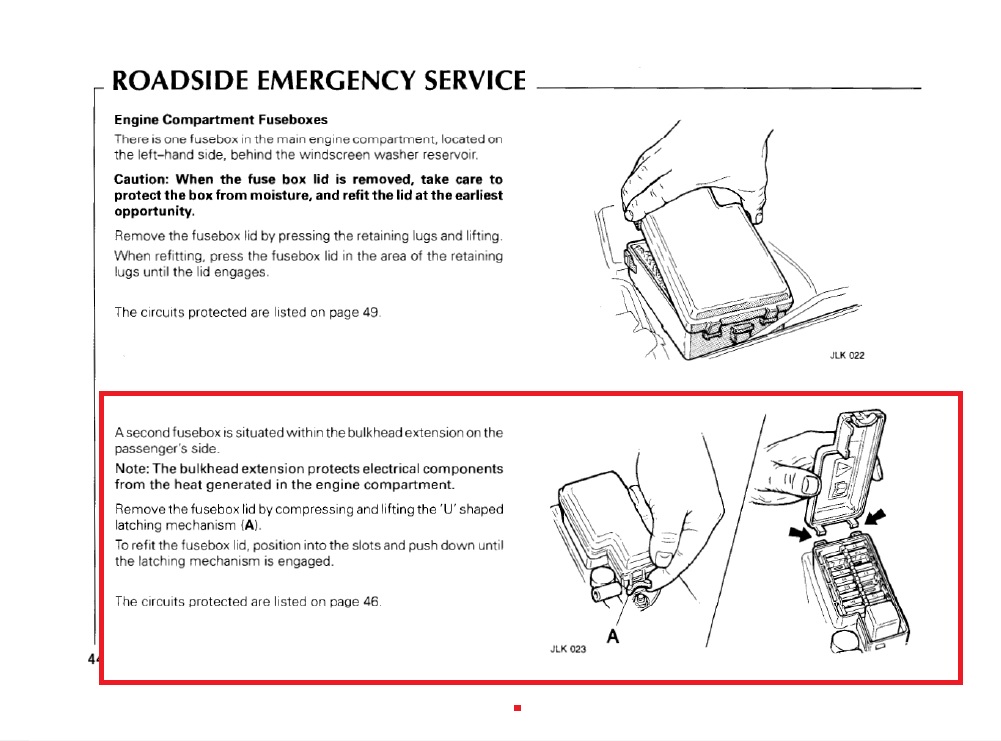

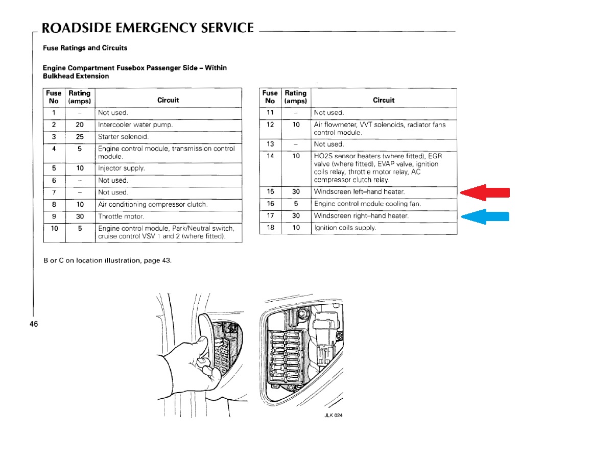

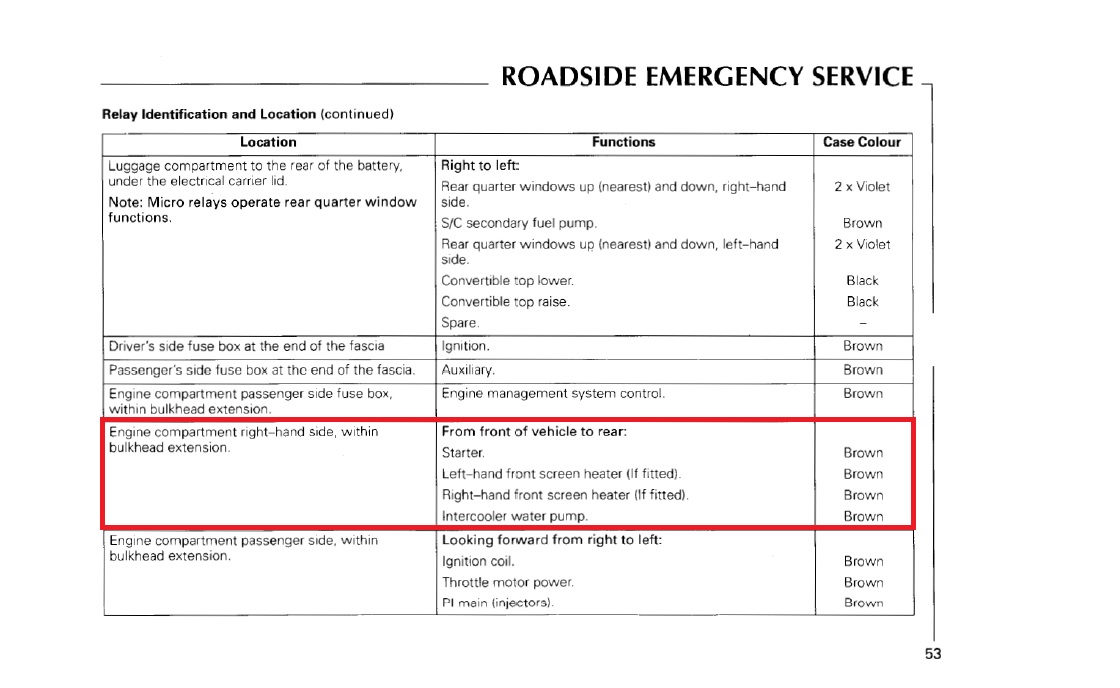

I'd also suspect a wiring fault but the windscreen heaters are independently fused left and right:
They also have separate relays:
Attached Thumbnails Heated Windscreen-heated-windscreen.jpg   Heated Windscreen-heated-windscreen-2.jpg

I think there's confusion between passenger side fuse box in the engine compartment, and passenger side fuse box at the end of the fascia. The table in Graham's post says "engine compartment" but the picture is of the fascia fuse box.

There are TWO fuseboxes in the engine compartment - both on the passenger side (on UK vehicles)
There's the one you found, and there's another which is under the plastic cover within the "bulkhead extension" (where the ECU is) which (I think) is the one you want.

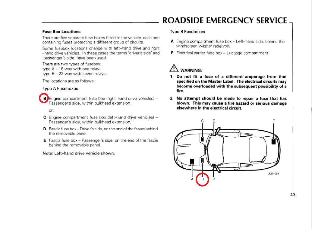

There certainly is confusion - and I'm the one causing it!
The information on fuses and relays in my post #4 is correct but as David points out, I've shown the wrong fuse box. The correct one is B circled in red:
