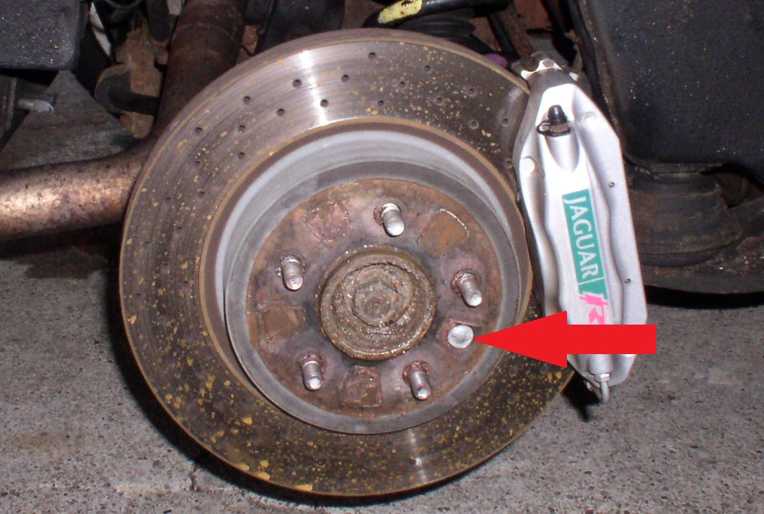

I can't see a blanking plug there to access the handbrake shoe adjustor .........?
Mine is cross drilled Brembo but the standard disc should have the same arrangement.
Graham...
Our friend Waterloo is having trouble with the FRONT rotor, not the rear!
Old Sep 13, 2013 | 07:44 PM
Now why didn't I see that!
