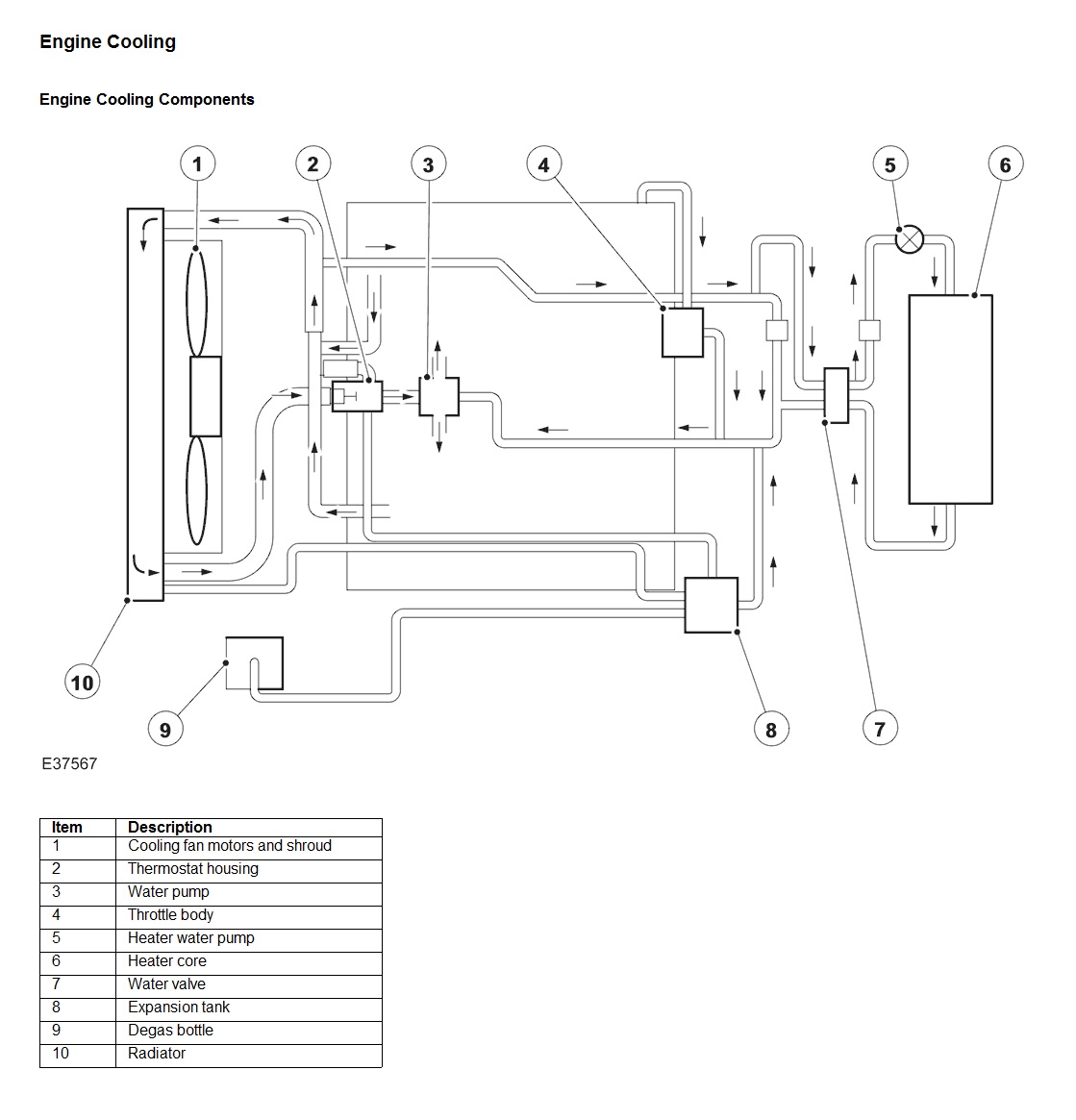

Originally Posted by cyber3d
Thanks for moving the post. Also, the drips are coming from the back of the engine. Can it leak that far back? Nothing leaking neat the front of the engine.
You'll see from the schematic of the Cooling System that there's several possibilities for leaking right back to the heater core:
As the water pump, thermostat housing or radiator aren't the source, the two hoses that run between the heads from front to rear are a known weakness as are small cracks in the Expansion Tank.
The XK8/XKR should not use any coolant unless there's a leak. Check/monitor the level in the expansion tank. Overheating the V8 can easily cause serious and expensive damage.
