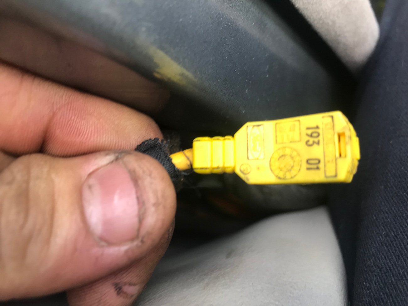

I spent an hour or so trying to figure out how to remove the Yellow SRS plug from the front passenger seat reel.
Then I spent HOURS on the internet trying to find out how to unplug this little plug --- Arrrrrrg!
It's the same plug from waynearny's post a couple of years ago. Here's a shot from his post.
How do I release this thing?????????
WOW - That's a big picture!
DUHHH - It pulls straight up - - I couldn’t pull it out and was afraid of breaking something, so I put a plastic body attachment removal tool under it and it popped right out.
