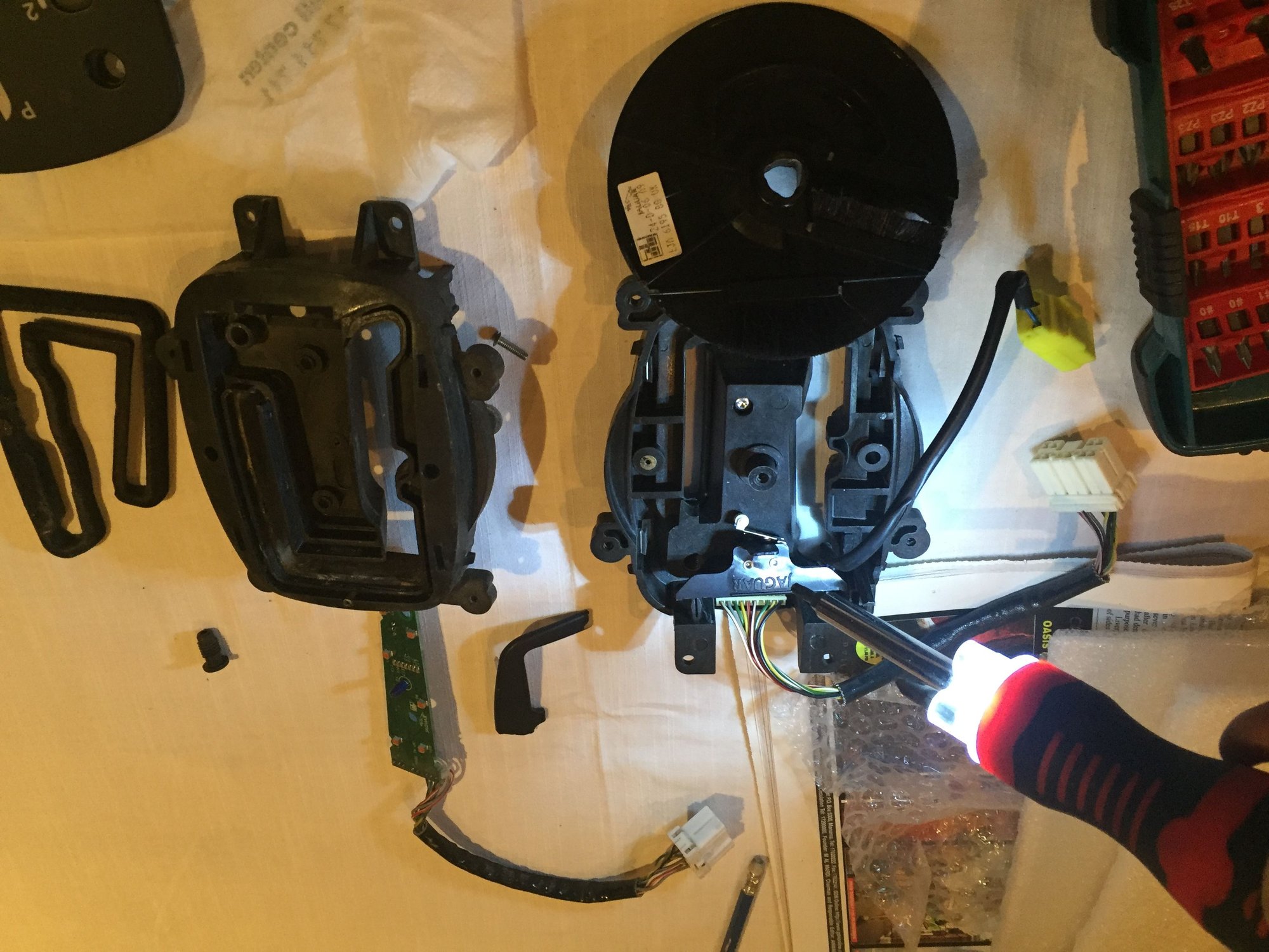

Default Maybe microswitches in the J Gate module
As all is well in D - drive, it may be worth looking first at the J Gate gear stick module. Lots of microswitches in there that could be the source of the warning. Easy DIY check with a sticky thread with the Rev Sam Youtube video.
I’ve an old pic below looking at the J Gate module parts
