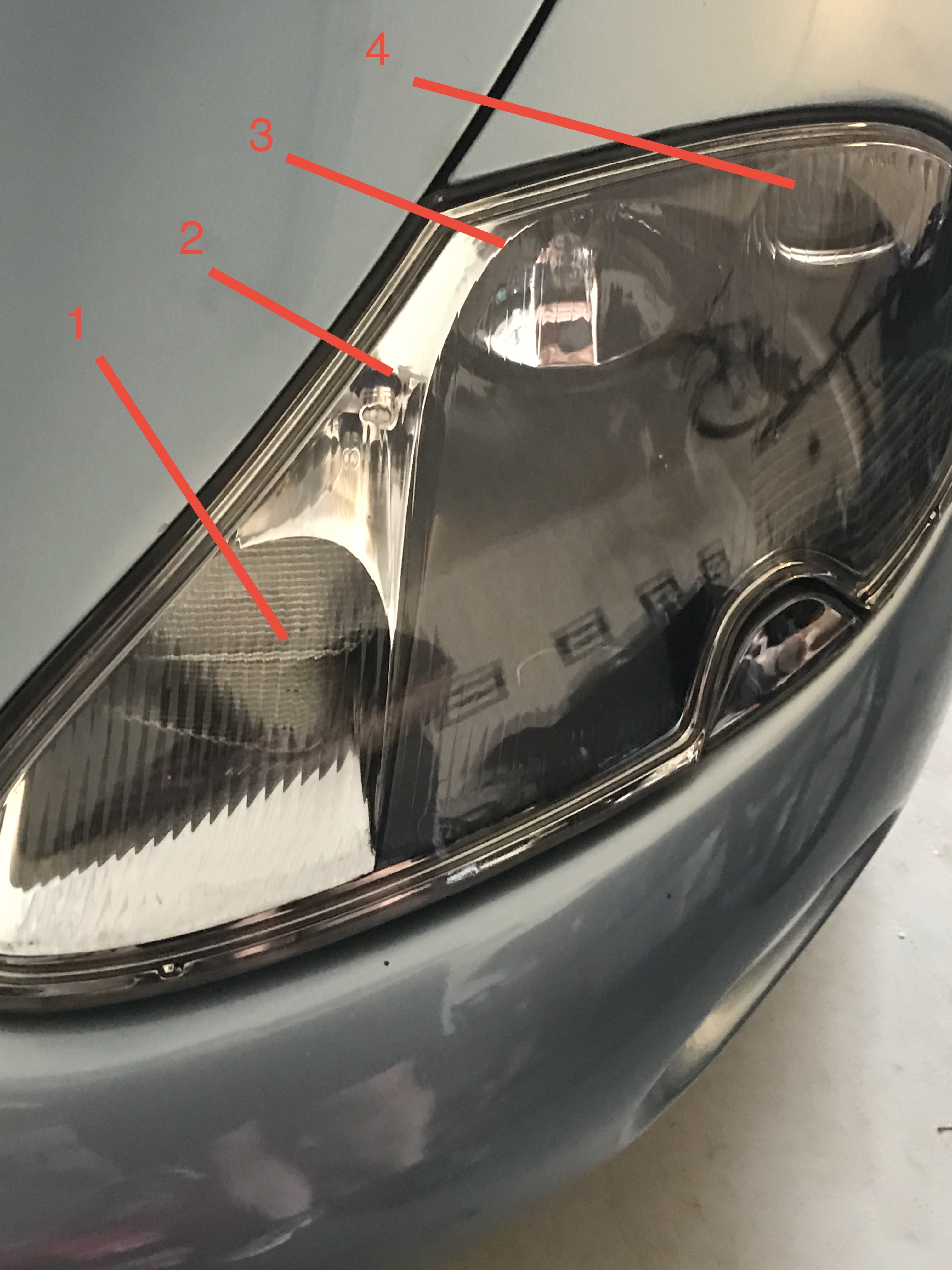

Sorry guys, I guess I'm dense. Below is a picture of my headlight and the 4 bulbs that I am aware of (numbered 1 - 4). Right now, I need bulb 2, but would love to associate a bulb type (or jaguar part number) and function with all numbers.
Any assistance would be amazing!

Ok part 2 is:
C2S15074020 - 5W Wedge Bulb. This is a 2825 Bulb.

dsd,
#1. Turn Signal Bulb - 12496 or 1156 (Amber)
#2. Parking Light Bulb - 2825 (This Bulb fits Side Markers & Side Blinkers)
#3. High Beams - 9005 Halogen or Sylvania Silver Star zKe's (Super Bright White)
#4. Low Beams - HID D1S
#5. Fog Lights - H1 Halogen or Sylvania Silver Star zKe's (Super Bright White
If you really want to go all out, get an LED Kit for the High Beams...They cost around $60.00 to $100.00. You don't have to worry about he length of the LED as the High Beams only have a reflector and the actual Headlight Glass is the cover. I have installed the LED's from Superbrightleds.com and they cost about $75 to $80 bucks....
Man they are "BRIGHT".....Good Luck to you!
Billy Clyde in Houston
