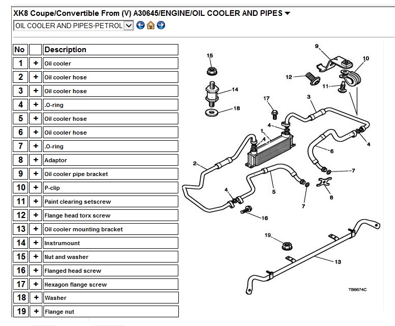

This extract from the Parts Catalogue is the best illustration I can find:
Plenty of connections in the pipework to check. Several members have previously reported failures with the hose ends although impact damage to the oil cooler itself is not unknown.
