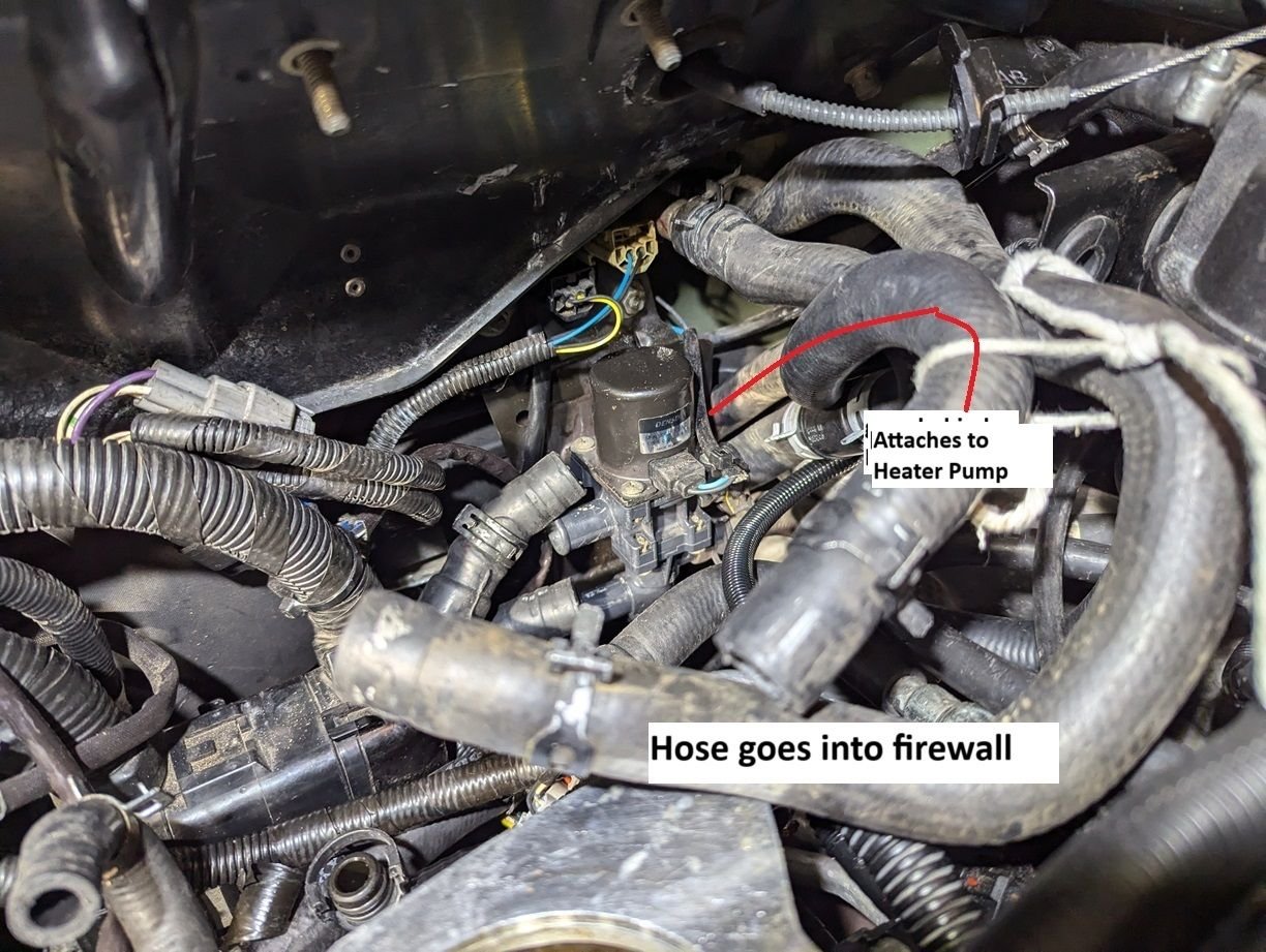

I had to fix my heater pump and I guess i did not take enough pictures. I took off the throttle body and then the heater pump and got that fixed. Now I have two coolant hoses I can't for the life of me figure out where they attach to. I thought I took good pictures during the disassembly but obviously did not. Does anyone know where these go. I have all the heater pump lines connected, who knows maybe i did that wrong.

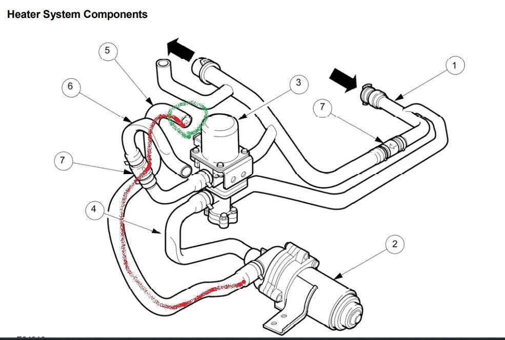

The attached pdf snip should help.
The large arrows show the connections to the valley hoses, 5 & 6 go to the bulkhead,
and the remaining upright, IIRC, to the underside of the coolant reservoir

That is helpful to an extent. I changed my first picture. The Hose #5 is one of them that i cant figure out. I have it attached to the pump but I don't remember where the other side get's attached to. Where does the end that I circled in Green go. I cant believe I did not record all this when i took it apart...

Oh man, I think I figured it out. Both of those hoses are the same part. I purchased an extra heater pump/valve assembly and I think I left the hose on it and left the one in the engine.
I just could not figure out how I could have two hose ends and no place to put them.
