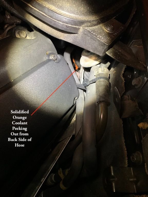

Finally got around to figuring out where the infinitesimally small leak was in my cooling system (loss of about a cup over ~2 months or so). Smells vaguely like coolant from the vents after a bit of driving (have been using recirc to get rid of this, so probably not the heater core). Nothing on the garage floor. Pressure test drops about 1 psi starting at 15 psi over about an hour. Valley hoses/octopus appear to be newish and unsullied. Thermostat housing is aluminum.
Anyway, finally found this orange stalactite at the bottom of this hose. Hopefully this is the issue, it certainly is some issue.
Orange stalactite, poorly focused cell phone picture

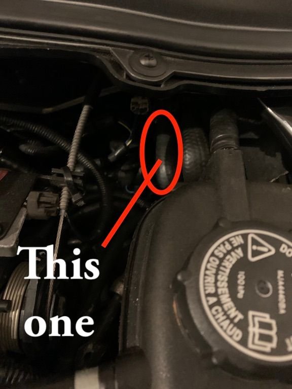

It's the one towards the centerline of the car of the pair coming out of the firewall (not the one that appears to have the check valve). Two questions in case anyone happens to know. 1) Is the part number MJB6720AC? The diagram is not particularly clear. 2. How hard is this to replace by removing the coolant reservoir but not the throttle? Do I need my daughter's hands for this?
This one is MJB6720AC?

Hi Dale,
Probably not what you want to hear - the inner hose of the pair at the firewall routes to the side of the water pump 'Water pump to heater hose' MJA6721AG.
Unless your daughter is a magician you will need to remove the assembly somehow. RaceDiagnostics went from the top:

More quick investigation today, appears to be 'blowing by' (dripping by?) the firewall joint on the underside of that hose, tiny rivulet leading down to the 'stalactite' that cannot be seen without twisting the hose. Literally as if it was a stalactite from repeated tiny drips over a fairly long time. No one has that hose locally (i.e. all 5 dealers within a couple of hours) which also gave me the idea it wasn't a particularly common failure, the dealers have generally had the other hoses that found themselves to be inadequate in my cars.
