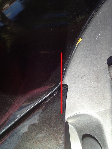

Here is the problem.
Attached Thumbnails How to adjust hood(bonnet) gap-12542110853_d3596b1dd2_d.jpg   How to adjust hood(bonnet) gap-12542100053_d69e534632_d.jpg
Old Feb 15, 2014 | 05:49 PM
Likes: 17,015
From this pic, it first needs to move forwards on both the hinges to approximately halve the gap between the front edge of the bonnet and the bumper:
That will pull the rear edge forwards the by same amount to bring it into line with the fender:
Once you have it located correctly with an even gap all around, if it is too high (or too low), this can be adjusted on the striker/buffer bolts.
