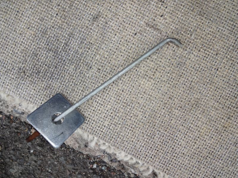

The first time I had to put the steering rack back onto the car (this was a year before I made the video) I also had big problems with the spline and u joint, I couldn't get it past this point.
In the end I made an improvised slide hammer out of this to "pull" it on to the pinion.
The second time round, totally removing the U joint and cleaning/de-rusting it made the job far easier, although there was nothing easy about it.
