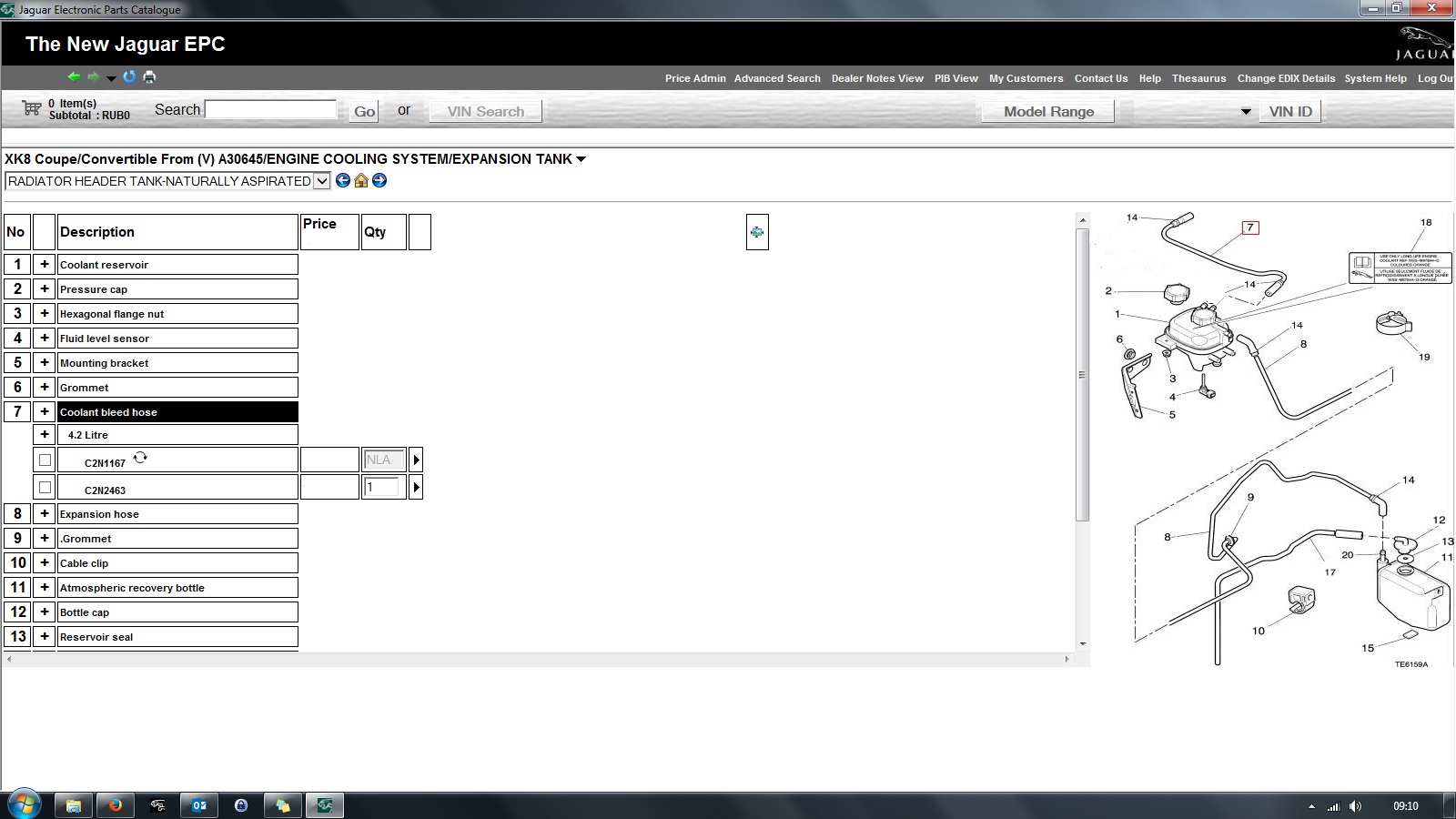

The Bleed Hose (item 7) from the Reservoir (item1) is leaking?
1. you can easily replace the Bleed Hose yourself
2. a subsequent pressure test is unnecessary
A pressure test is used to determine the source of a leak. You already know where this is!

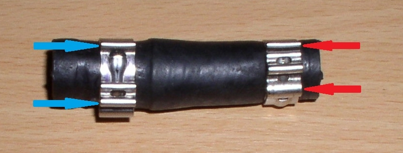

The Bleed Hose is connected with Norma clips:
There is a special tool for these but they can be opened and closed with pliers. Squeeze the red 'shoulders' together to open; squeeze the blue 'shoulders' together to close.
Attachment 106493
Attachment 106494

In my photo in post #3 above, the clip on the right is closed; the clip on the left is open.
There's four 'shoulders' on the clip. Squeeze where shown by the red arrows (1+3) to open. Squeeze where shown by the blue arrows (1+4) to close.
I disagree with that.
Norma clips are used on plastic cooling systems for two reasons:
1. speed of assembly
2. constant force - they cannot be overtightened
It's the second reason that is relevant. Worm-drive clips can very easily be over tightened to the point where they crush or shear the outlets from Expansion Tank or Thermostat Tower.
Many DIY'ers will tighten worm-drive clips as tight as possible which is OK on a steel or aluminium connection but very risky on a plastic connection.

Graham,
I hear you on the Norma clamp vs. worm-drive clamp issue. Yes, you must be careful not to overtighten any clamp on any plastic nozzle. If you are indeed careful, I still believe that worm-drive clamps give you a better chance at avoiding leaky connections. I've long been guilty of cranking bolts down too tightly but I always resist that urge when I'm dealing with plastic parts. Thus far all the worm-drive clamps I've used in our two Jaguars are holding up nicely. But if Jaguar had used better plastics in the first place, this issue would not be nearly as common as it is....
