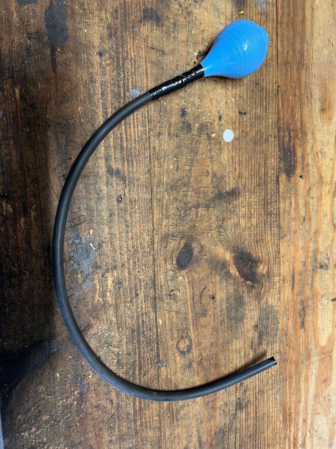

motorcarman's Avatar
Posts: 13,707
Likes: 9,651
From: Wise County,TX
PENTOSIN CHF 11S.
It is your car and you can use anything you want but Jaguar recommends CHF 11S.
I had to drain/fill dozens of convertible top hydraulic systems a few decades ago when Jaguar changed fluid specs. and issued the TSB.
I still have a partial bottle of UNIVIS on my parts shelf. I keep it for a reminder of the 'good-ol-days'!
