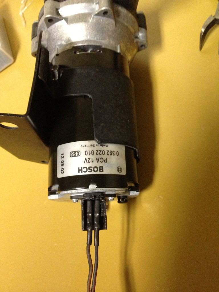

Took the pigtail from the Hella pump.
Cut the connector plastic to open it up and used some connector pins left over from the bluetooth install. Slipped the pins onto the pump connection and soldered them in place.

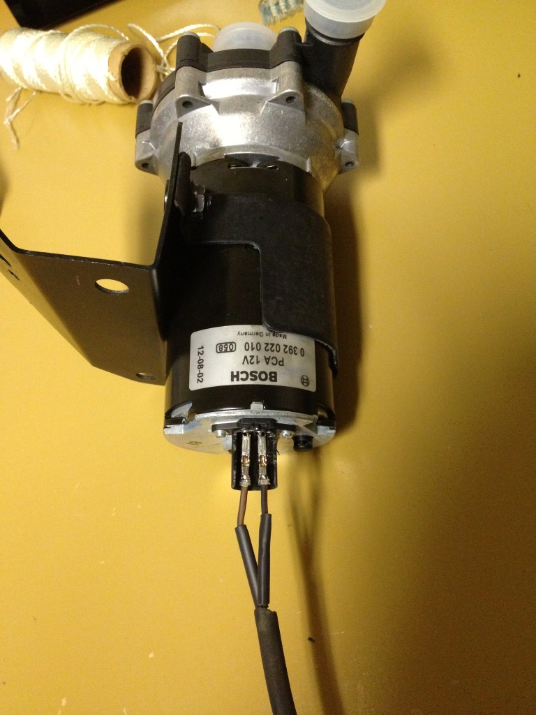

Shrink tubing over the connections so they can't short together.
Some electrical tape over the whole thing to keep dirt out and be a strain relief.
