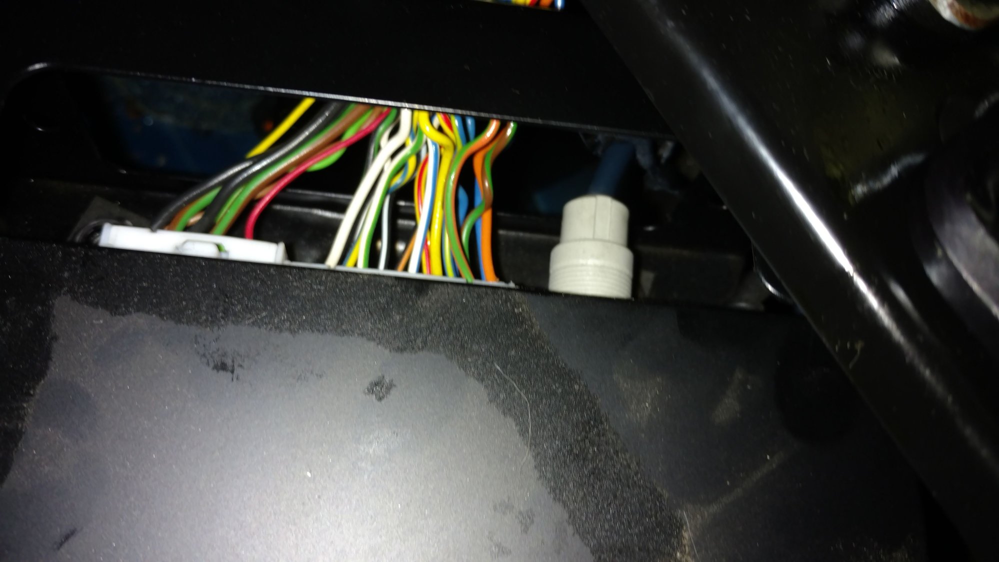

so - a very late follow up.
I finally got the plug out - and it *is* the copper wiring AI-Net plug, and ultimately I took a pair of needle nose vise grips, set them to *barely* squeeze the connector (which I *thought* was plastic but had a rubber cover) and then used the pliers to lever the plug against the case to pop it out.
Here's good picture of the plug I was fighting with.
<sigh>
After that, the entire inner frame was free to be removed.
I'll probably start another thread about the changer repair, since the title of this one won't help anybody searching for that info.
Thanks again to all that chimed in - it's greatly appreciated.
