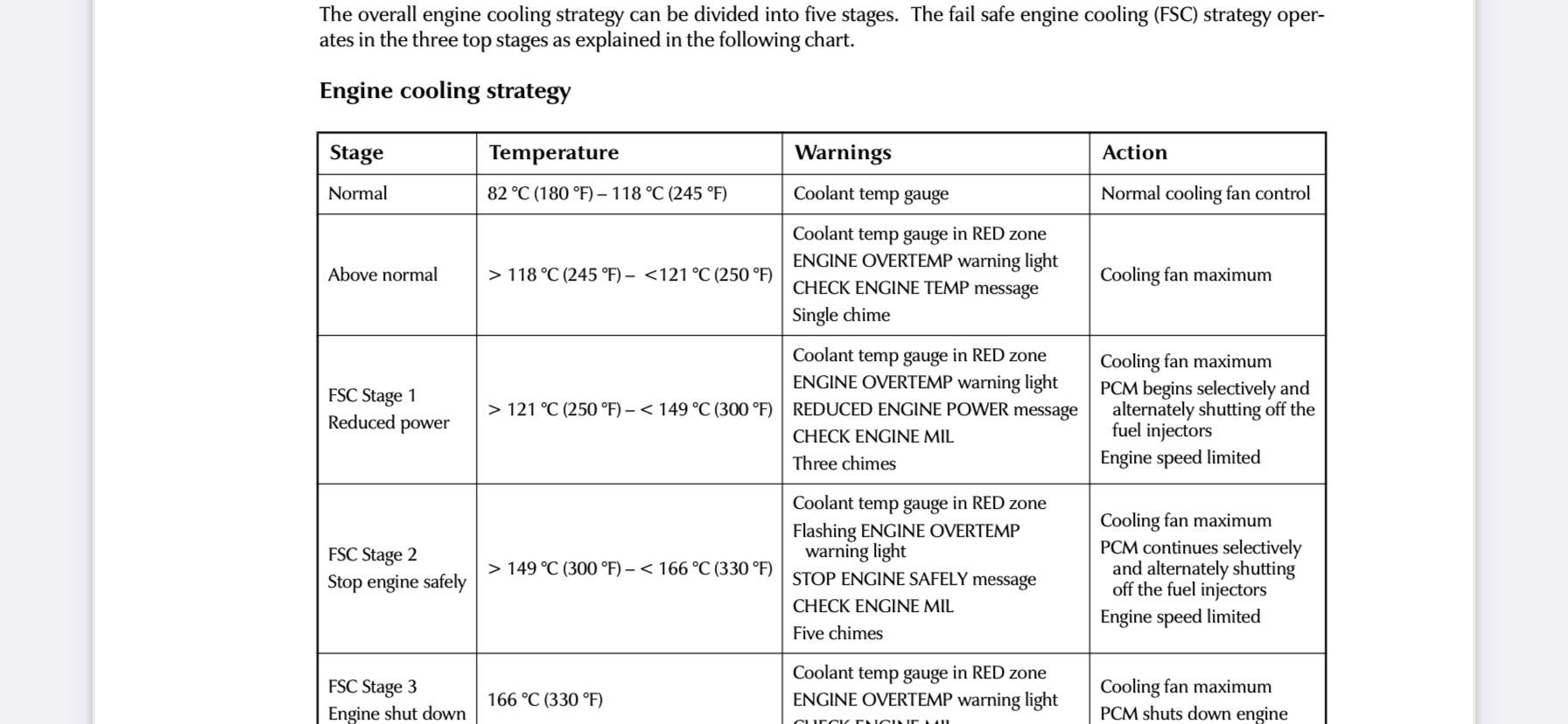

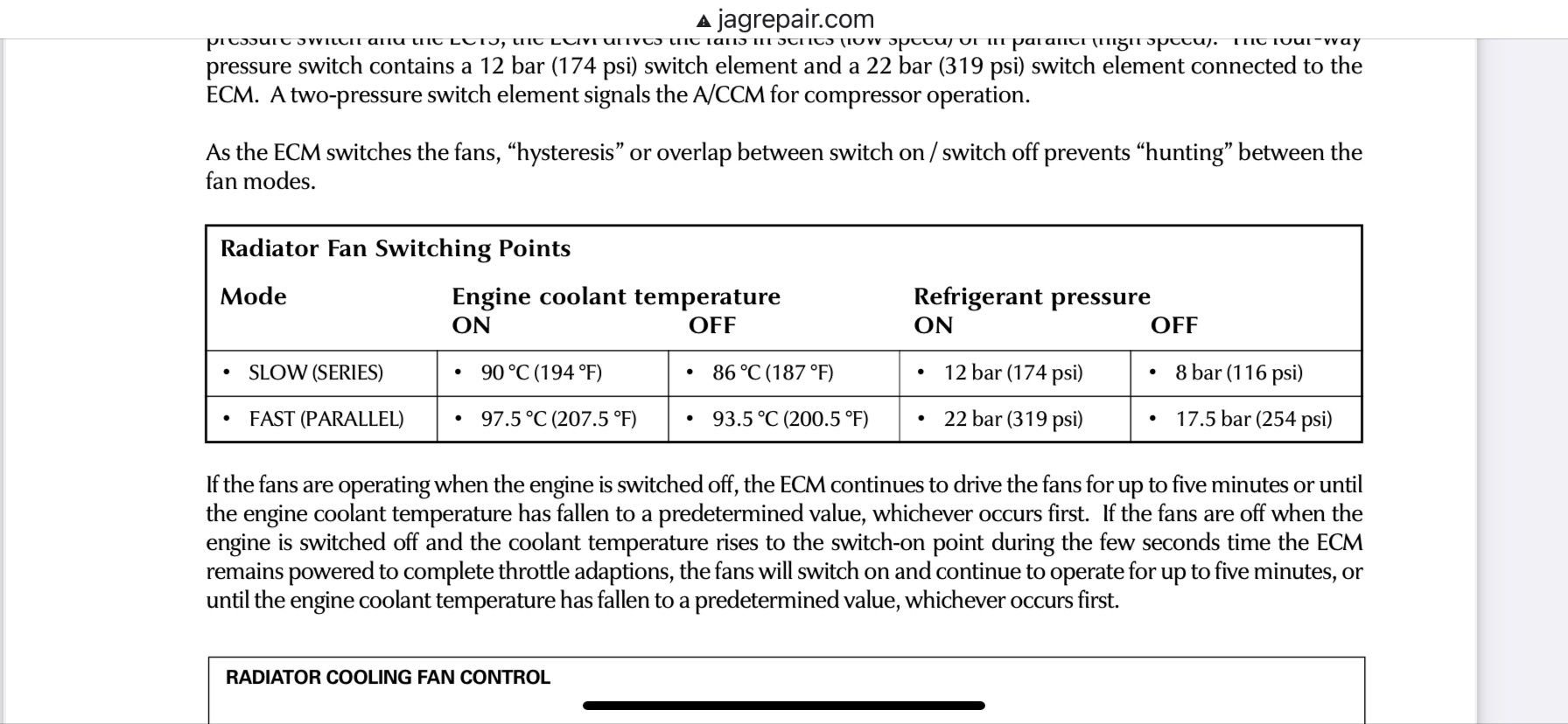

More temperature related information from Jaguar shop manuals:

zray, would you mind posting a link to source of the above noted values on coolant temp. Reviewing the total section could reveal more interesting info. Several searches in past have proved unsuccessful from my end. One may think the 4.0L and 4.2l use similar logic? This is much needed info and the allowable temps vary widely. Would have expected the normal running temps to be 195' or bit higher. Generally, higher temps allow leaner mixtures( - fuel trims) and lower temps allow rich (+ fuel trims). Thoughts on this?
Old Nov 6, 2021 | 09:45 AM
zray's Avatar
Joined: Jan 2018
Posts: 3,748
Likes: 2,340
Here is a link to previous discussion. Scroll down to (my) post #4 for the link to download the Jaguar Service Training Course #881.
https://www.jaguarforums.com/forum/x...points-247579/
I think both of the illustrations I posted are from that training course. Section and page number given in post #4 referenced above.
(Pages #118 & #244)
note: on most warm(er) days, of 75 to 95 F, my coolant temp is normally well into the 190’s F if not higher . Or the 88 C to 93 C range more or less.
