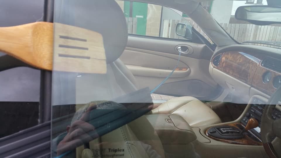

Hi All....I noticed another thread relating to how to access your car and boot (trunk) without the key.
I recently had a similar conundrum....on trying to unlock my car by key at the driver's door lock. Before you say anything...my keyfobs don't work and never have...and...I set my car up to disarm the alarm system from the key...rather than having to quickly turn said key in the ignition before the alarm went off.
1) So...turn key in door lock...feels loose with no resistance...and door does not unlock
2) Realise that the connecting linkage from the lock to the lever on the door lock mechanism, that activates the microswitch, that unlocks the central locking, has come apart inside the door
3) PANIC!!! SWEARING! EXPLETIVES! GUTTED!!
4) Realization that I have the key....so can open boot and disconnect battery terminal and thus stop the alarm...which would go off and keep going whilst I tried to fiddle with things
5) Go into MacGyver Mode and try to figure out a way of opening the doors (coupe...not convertible!)

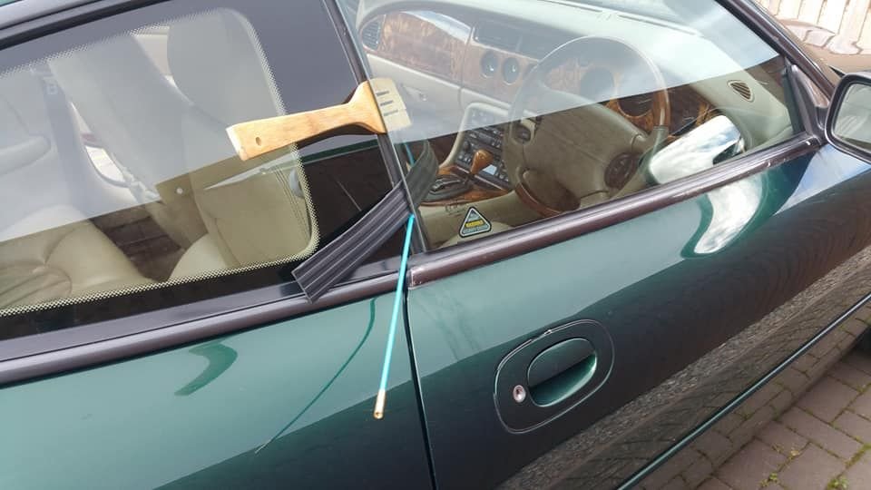

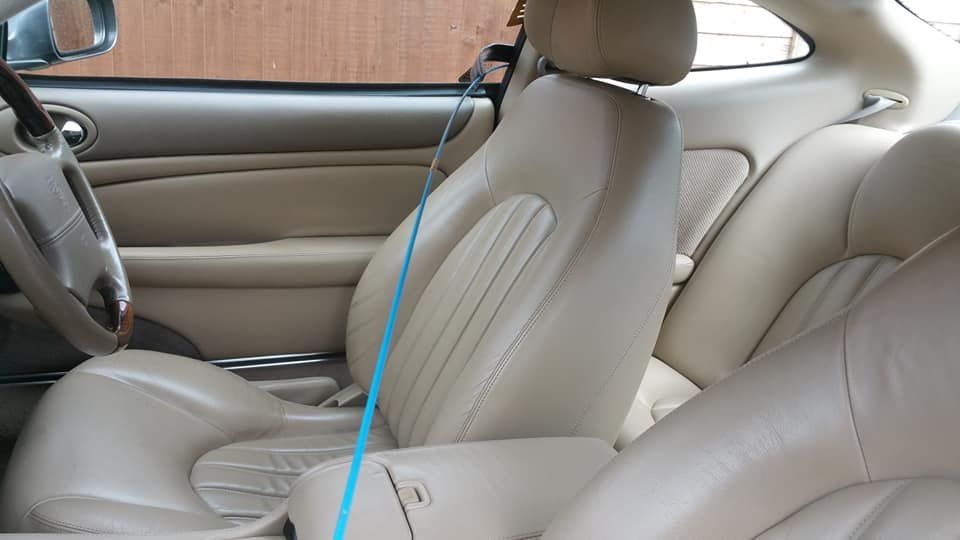

6) Saw that I could push something thin between the rear vertical edge of the door glass and the door frame rubber...so remembered I had a home wiring cable access kit that I bought from Aldi a few years ago....I attached the small hook provided and screwed two lengths of the access rods together and so inserted that into the gap

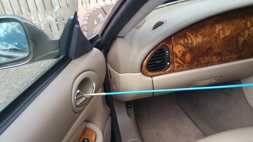

7) Managed to get in the general area of the opposite door handle..but couldn't get the hook over far enough...so needed something thin with a bend in order to guided the rods towards the door handle
8) After searching and scratching my head...I found a short length of lawn edging strip (used to separate the grass from gravelled areas) that I had just bought and used in my garden the week before....it was naturally curved and quite stiff (no schoolboy comment here please!) as it had come rolled up...so I adapted it and cut a slot in the end for catching and guiding the rods
9) A couple of minutes later...and after a few attempts...managed to place the small hook over the opposite side door handle...and...a quick tug..and the door popped open!
10) Much relief...followed by another 2 hours of gynaecology inside the driver's door...and the lock connecting rods were fixed and again working perfectly
P.S. the wooden spatula was used to first open up the gap between the glass and the door rubber so as to minimize the risk of damaging them.
And I am keeping the said plastic lawn edging piece in a safe place in case of any possible future problems
I hope you find this useful, informative and amusing....and do note that even though it clearly shows how to get into the car without a key....I do stress that I had the black key and was able to get into the boot (trunk) in order to disable the alarm by disconnecting the battery. And that none of this would have been necessary if my keyfobs had worked!!
