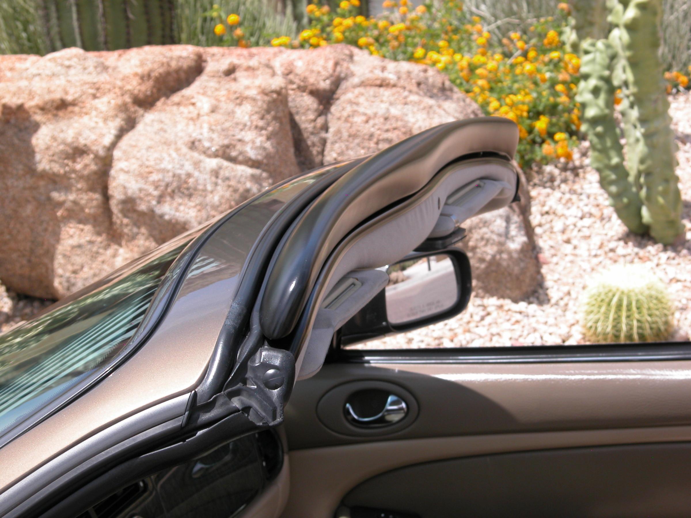

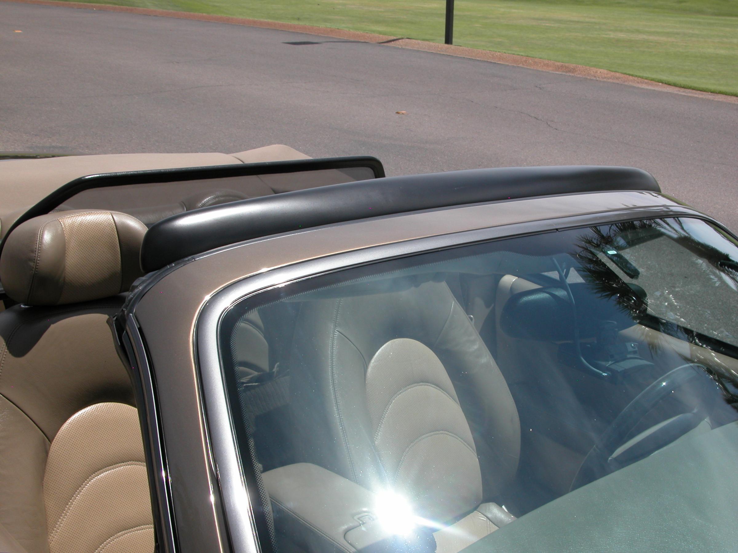

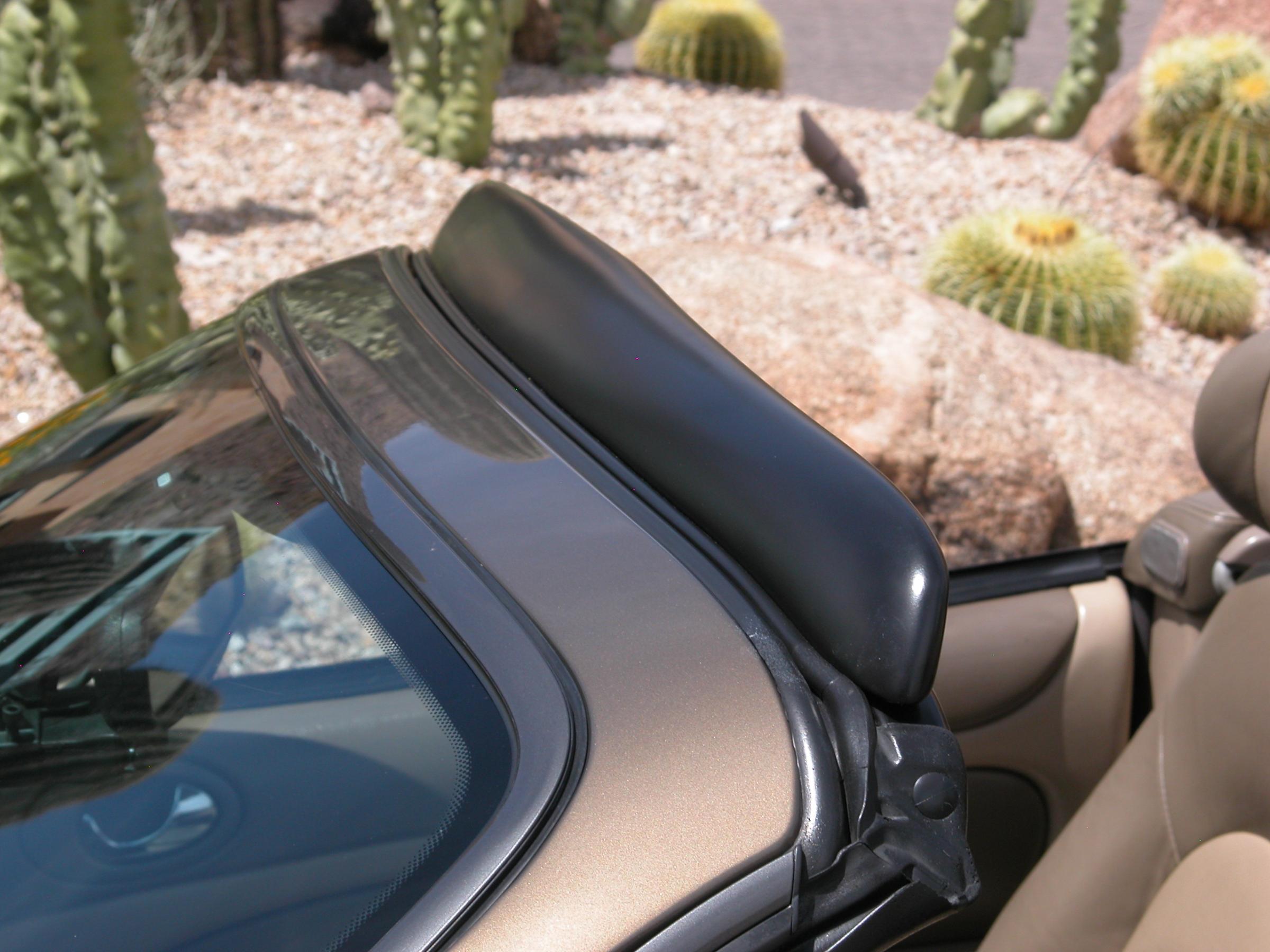

Ok with that said, I decided to create and build a add-on piece that would significantly cut down on the wind factor in the cabin when the top is down. (Hopefully!)
I call it a Wind-Dam, for lack of a better name. But it is descriptive.

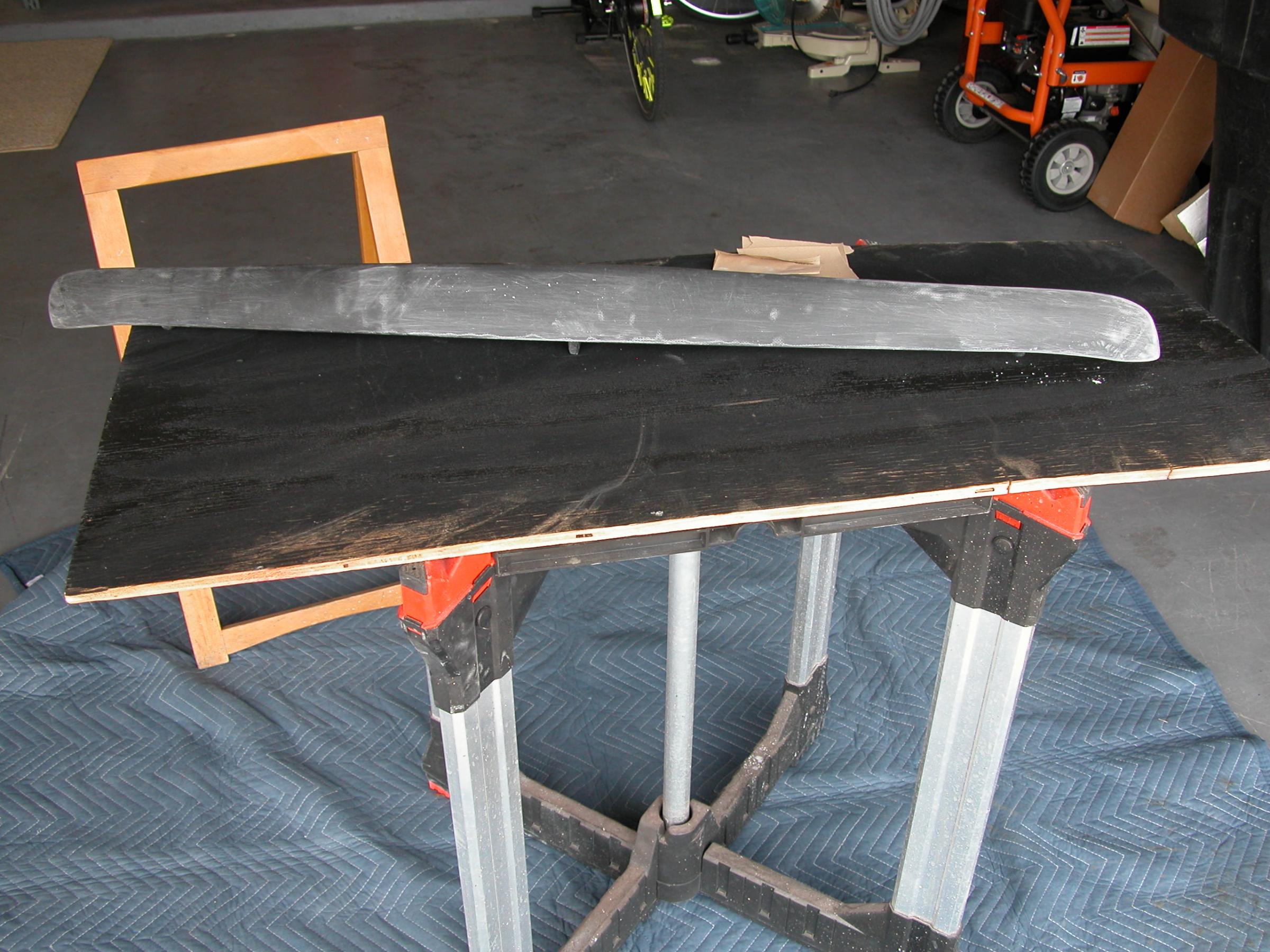

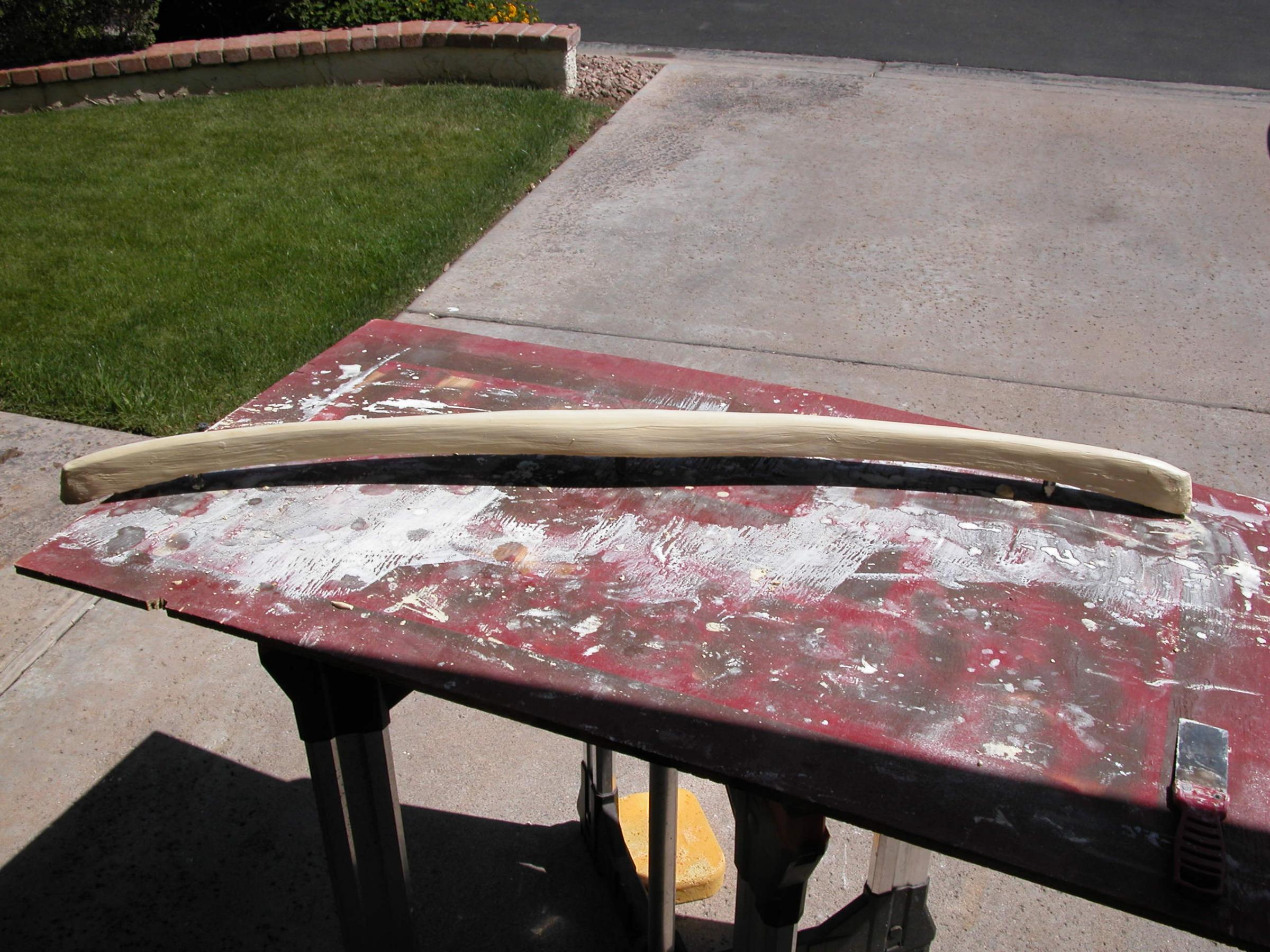

I started with a piece of foam insulation and glued several pieces together and started carving. It took a couple days or so to come up with the basic design and another couple weeks to get the finished product, which is fiberglassed and painted with trim black paint and UV matte clear coat for a professional looking finish.

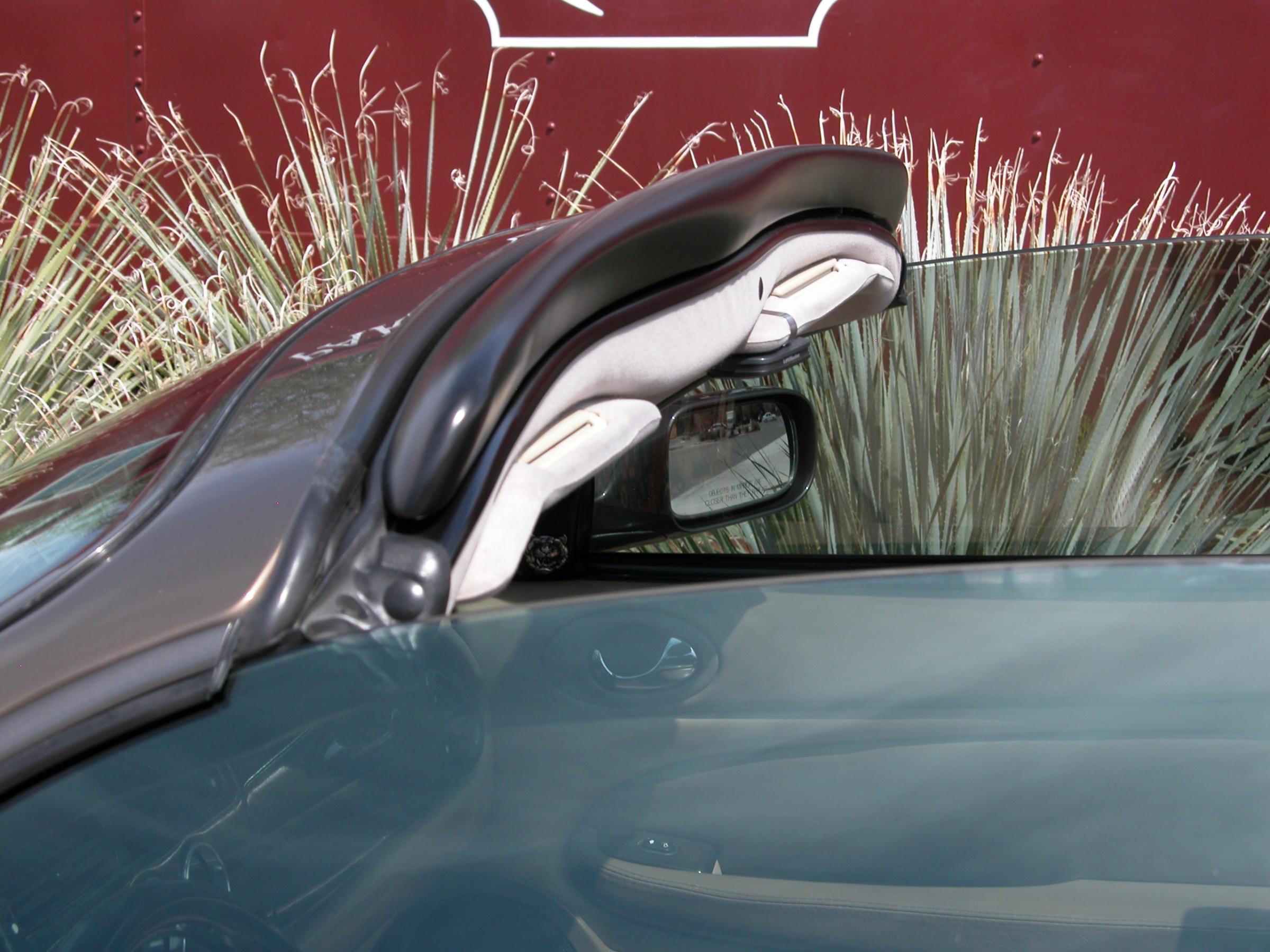

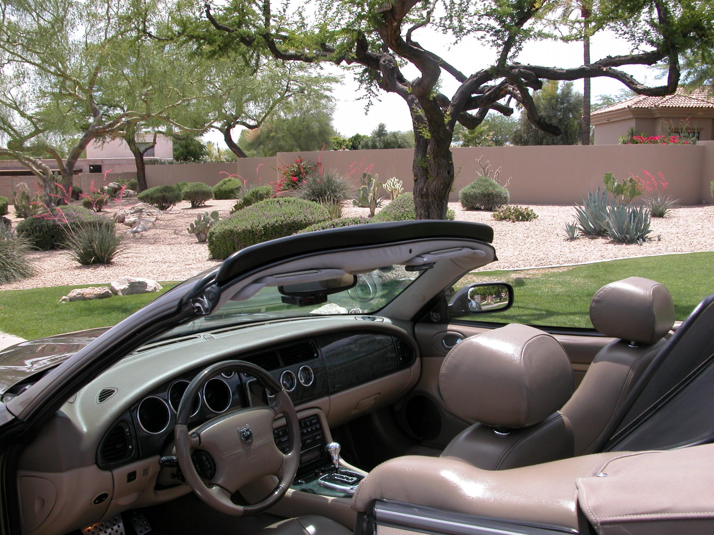

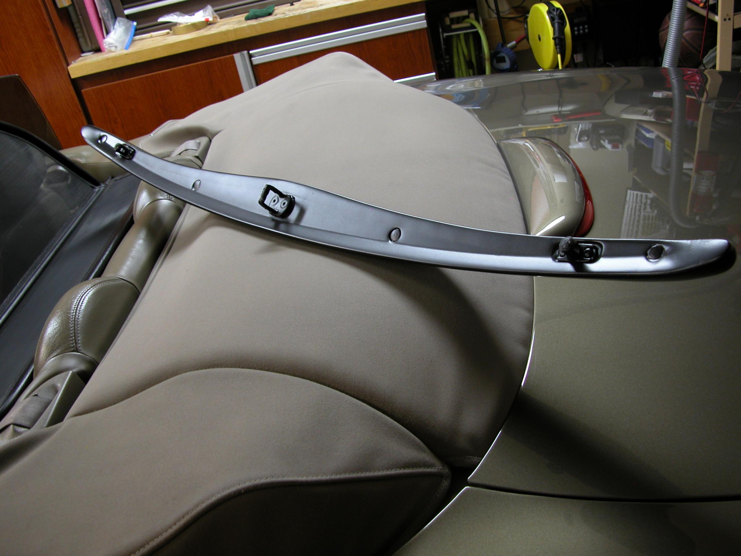

The Wind-Dam connects to the windshield frame exactly the same way the convertible top does and it takes about 5 seconds to connect or release the Wind-Dam in place. It is very secure, as it uses the same plate that has the hook and 2 guide pins to put the convertible top in a closed position using the convertible top close/open push button on console . I have had it in place for 3 months now, no hydraulic problems, the convertible top sensors think the top is in closed position even though it is not. The dash message cell will say "convertible top not latched" for about 2 minutes during install then goes out, each time unit is removed and then reinstalled.
The Wind-Dam came out quite well. Looks good and works great. IMHO!
The Jaguar convertible top Wind-Dam does several things.
#1. Of course it cuts down on the wind in the cabin area (about 85%) IMHO! I can place a single piece of paper in passenger seat at 75 MPH and it does not move !!! and yes, there is still some wind but not nearly as much, windy weather will not help things either. It is a noticeable major improvement but certainly not perfect, for that you will need a Demi Moore cut, the top closed and windows up!
#2. Cut down on wind noise at ear level considerably (less wind passing the ear), makes for easier conversation and much better sound quality from stereo.
Even the hands off microphone for the phone system works much better.
#3. becomes a sun visor for the early morning and late afternoon hours. cuts out the sun for about 3 hours in morning and dusk. (of course depends on time of year and your location)
#4. keeps the cabin warmer or cooler, less air movement means A/C or heated air stays in cabin better when top down.
#5. and of course it keeps my wife much happier..
she does not need the top up anymore unless of couse there is imclemnant weather her choice.
The wind is cut down that much!
30 to 80 MPH no problem!
With the Wind-Dam in place the front windows, rear windows rolled up (WhiteXKR upgrade,Thx.) and rear windscreen in place it is like a cocoon with much less air/wind movement and that creates significantly less wind and a much quieter cabin.
I have included some pictures for your perusal.
I think the Wind-Dam actually looks good in place as if it was a factory part and it actually works better than anticipated.
I would not want it even if it worked perfect but looked out of place.
My wife is happy, which makes me and my Jag Convertible HAPPY
Ok, now for your opinions and/or questions.

I have to say that looks pretty slick and almost OEM. I was wondering how you actually install. Obviously you lower the top using the switch but then how do you get the Wind Jammer (what I would call it) to latch on to the header? If you push the switch won't the top want to come back up?

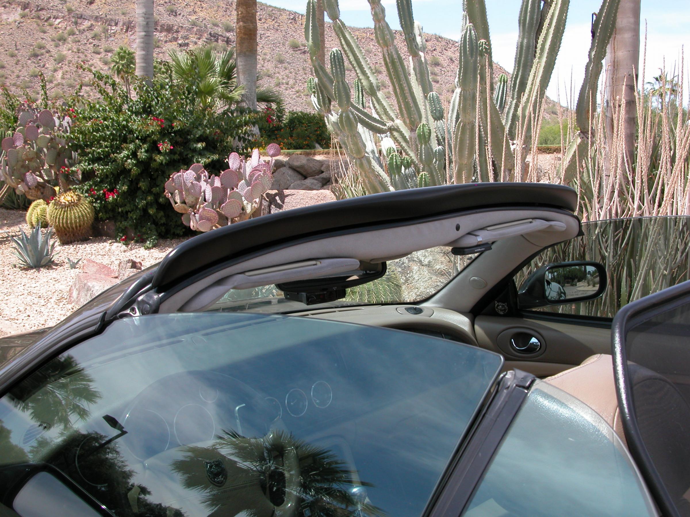

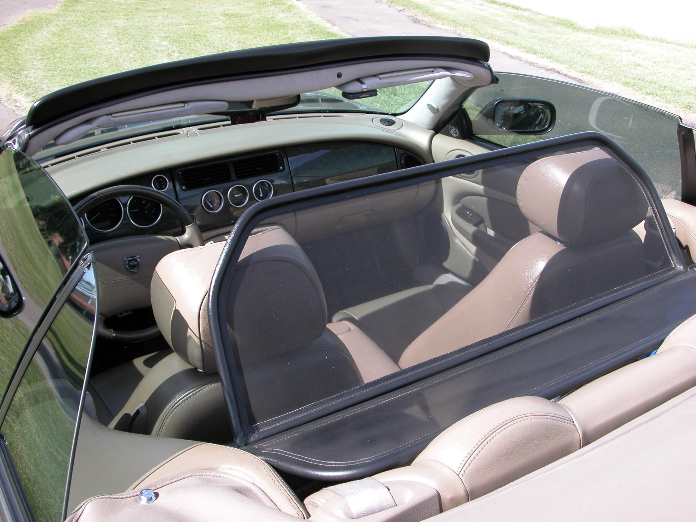

Notice you have a rear seat wind deflector, also. How does the Air Dam perform without the deflector.

The workmanship looks very refined, nice work. I do Note you have a windscreen as well, with it down how is the 'turbulence' in the cockpit?
Just curious as to how just he dam works by itself.

Hello to all,
ok first thanks for the nice comments.
Answers to questions.
Question#1.
The Wind-Dam is put in place and removed very easily. The convertible button on the center console is pushed down the latch comes up immediately because it thinks you are putting the top down then it senses the top is in the down position and the latch then retracts into the top pillar when pushing continually or again.
When you raise the latch the first you push the down button is when you slide the Wind-Dam's hook into the latch and align the two pins on either side and then push the down button again and now the wind-Dam is locked in place. As I said previously the dash cell light will say "convertible top not latched" for about 1 ½ minutes or so but it is quite secure then the light goes off and will not come back on until the unit is removed and replaced.
This install and removal of Wind-Dam takes about 5 seconds either way.
Question #2.
Ok, I have done some testing with the Wind-Dam in place with the rear seat windscreen.
The absolute best case scenario is with all pieces in place the windows in the up position front and back, the windscreen mounted in rear seat area and the wind-Dam in place.
But when tested with the wind screen taken out the equation the wind factor did not change much, the single ply napkin still stayed in place on passenger seat and I could not really tell much of a difference, this actually surprised me a bit!
My thinking for this is that the Wind-Dam actually changes the path of the air passing over it so that it actually goes past the rear seats and hits the trunk area thus it really does not make a big difference with the windscreen in place.
Of course I do not have a wind tunnel with smoke to attest to this hypothesis to actually see how the air reacts to the Wind-Dam. So this is all conjecture on my part.
I can say I think there is a definite and positive difference with the Wind-Dam in place with or without the rear windscreen and does not make a big difference either way.
The other plus, Wind-Dam is good for taller people I would suspect. I am about 6 foot and my forehead is pretty much level with horizontal pillar if you were taller you would actually be directly hit with wind.
With the air passing over the Wind-Dam it would raise the wind as to not hit a taller person directly in the head.
I hope this answers your questions.
