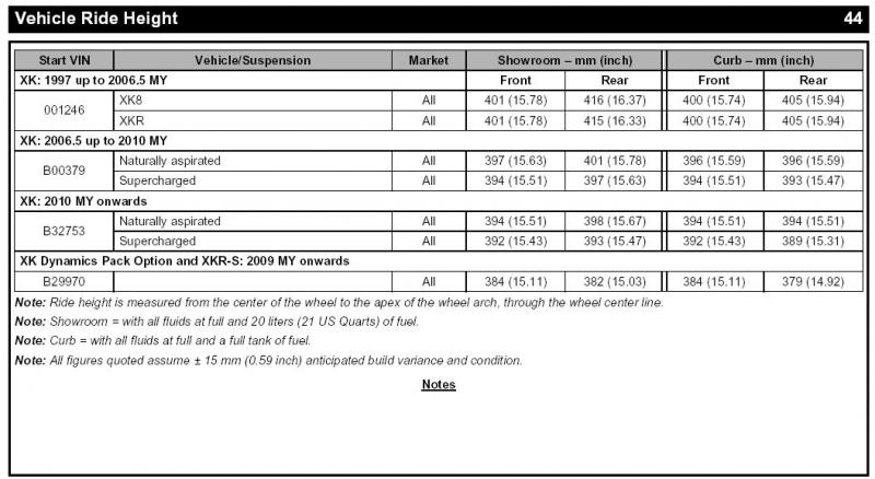

I know some people lower the rear springs to even out the car, was curious on what the exact difference is between the two?

If you are meaning the difference in ride height front to rear, it is described in this table:
