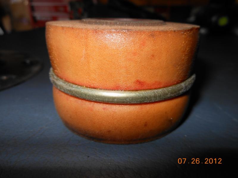

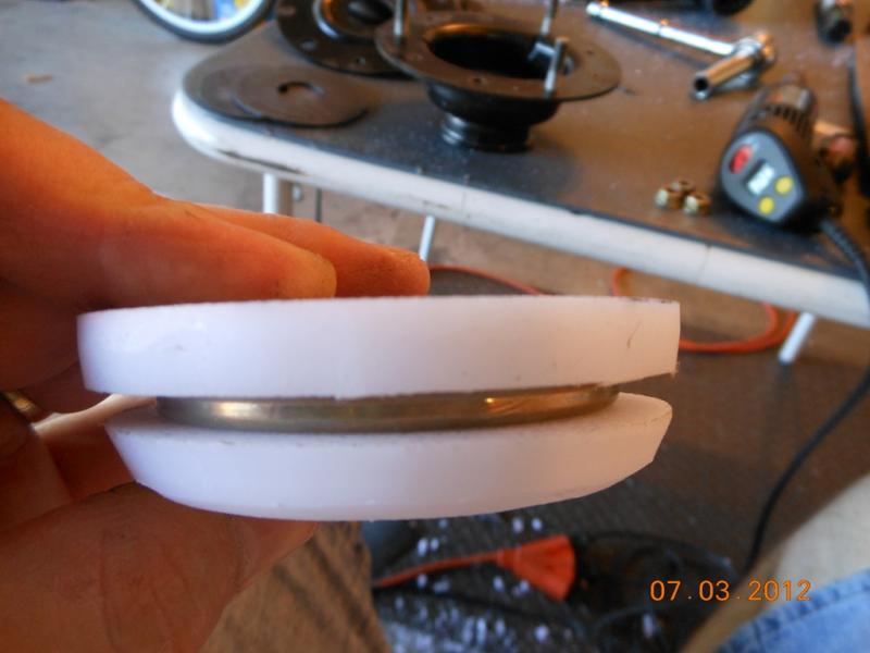

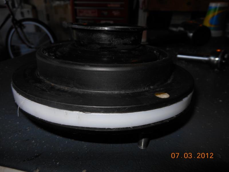

This was repaired using Nylon from cutting boards I purchased. I know this stuff works great, been using it for the past five years in other cars with zero deformity or cracking...
After everything was done it needed a upper spacer made from the same Nylon. Total front vehicle height 1"

For us neophytes to the upper shock mount bushing problem, what causes them to degenerate, at what age or mileage does the degeneration typically begin to show up, how can I monitor the condition of ours as time passes and the miles build up, and did Jaguar ever improve the components in the later model years?

Perhaps at the least you could gift the community with step-by-step instructions and a list of tools? It looks like you had access to a lathe to turn those shapes? How does the assembly fit back together - do you glue the sandwich, or use screws through the layers?

I wonder if there is some sort of semi-flexible epoxy that could be poured into the abcess created when the original foam is all gone. I can imagine compressing the springs to open up this gap, using tape around the outside of the area to create a mold, pouring the stuff in & waiting for it to harden. Hmmm...
