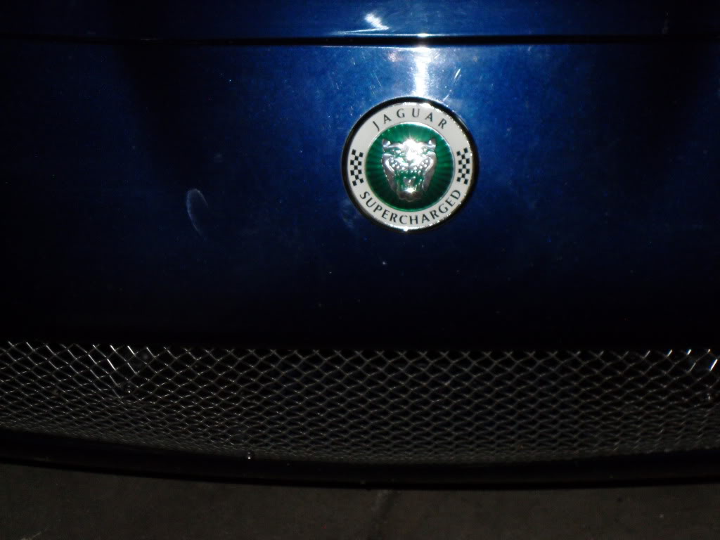

K.Westra-
Thanks again. Here is the picture.
