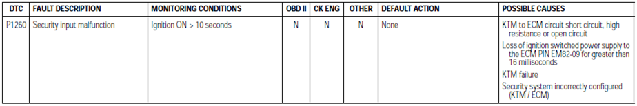

I suspect you may want to link this thread to your other one about code P1260, which is the cause of the symptoms you describe. You can change as many sensors as you like, but if the car has an immobiliser fault it is not going to start.

H Vincente,
Here is the listing for a P1260 DTC:
Do you have another key that you can try?

program the key with IDS
normally an uprogrammed\lost sync key will not even attempt to crank
